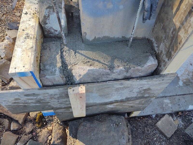

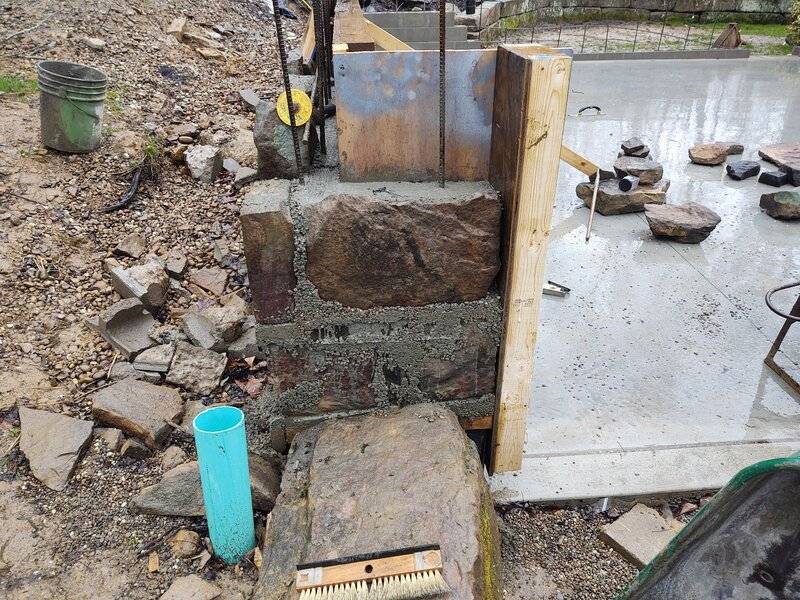

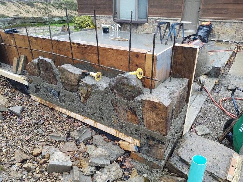

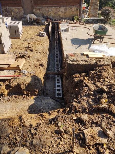

This one is for the wife but hey.. more stuff that can be unloaded from mine:thumbsup:. It will be 24'×28' with a bedroom above, 2' of stone wall then sided in poplar.
Thought some of you would enjoy seeing this rather unusual technique for using natural stones gathered from our woods. Last fall I did the footers, pad and block shooting to be above ground for spring, spring is here so here we go.

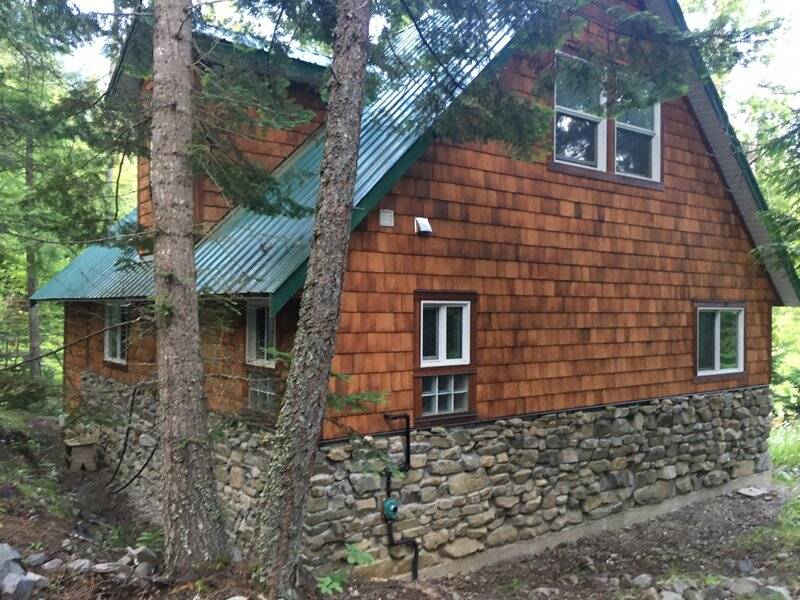

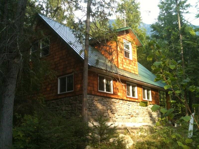

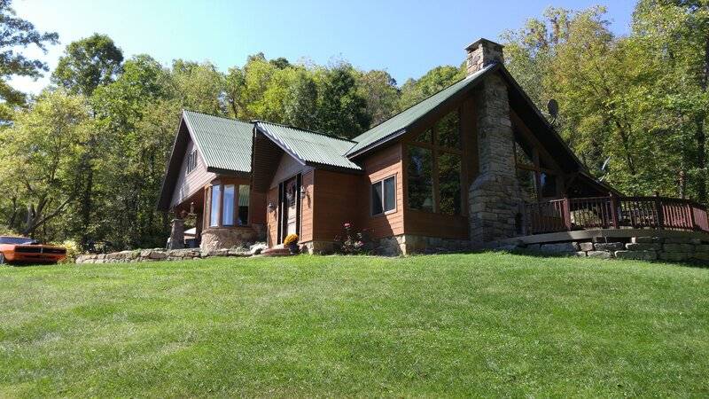

I used stone on the first 4 ft of my cabin. Really enjoyed the process
That's beautiful!! I love how much difference there is from one area to another as far as stone shapes and colors goes and appreciate the authentic look of real materials vs fake. I remember hating the process when I built our home but this time around I'm enjoying it. Last time it was July-August and miserably hot and humid plus it was postponing getting a roof on. This time I planned a little smarter, cool weather and plenty of time.
How did you do yours, was it mortared? poured with concrete? cabin sitting on top of it?

I looked at many different methods, slip form etc. ended up pouring a footing and free formed the stones. 22 inches wide. As long as my stones had 2 flat sides and once I got the hang of it things went well. Used a sticky mortar and lots of time. Wish I had stones like yours, they look great and are big. Enjoy

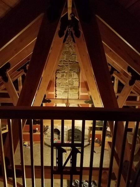

Love the stone work! One of my favorite looks, I did a fireplace and 30 ft tall chimney in a hunting lodge back in the 1980's. Loved the process. The 'float stone' on our fireplace and chimney is from around our property.

I was thinking the same about yours, yours looks really rustic like it would have been done which is what I was after where mine looks a bit more like cut stone. I'll have to take some pictures next time I'm in the woods to show you where they're coming from and why they're shaped the way they are. We have rocks as big as houses on the property.

Doing it myself except the slab, I have a friend that cuts me a good deal if I take care of the forming, ordering materials and help put it down ($1 per square ft).
I know what you're saying, I bought a sheet of 7/16 OSB and some 2×4's to build a couple forms and was shocked, $40 for the OSB out of the value rack (damaged) and something like $7 each for the 2×4's!! Metal roofing is through the roof as well, it's going to hurt paying that. I'm seriously thinking about using rough cut poplar to frame it. Sad thing is I've got maybe $20 in materials to build that much wall and close to $100 in building some crappy forms, fortunately those forms will build it all.

That was my favorite part of the house to build, the fireplace.
