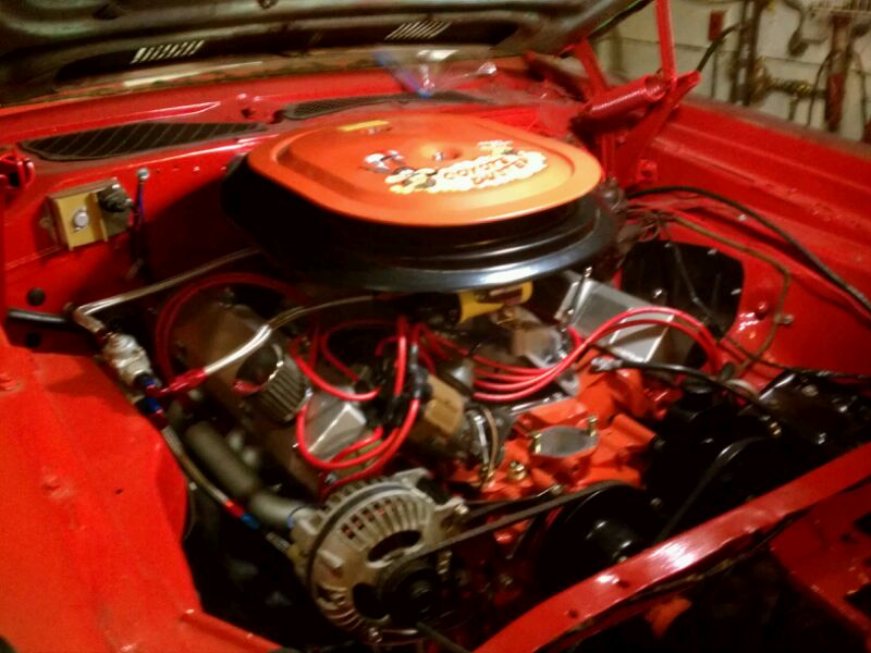

Well, i was lookin as my engine bay last night and thought, hey i should probably make sure my air cleaners going to fit still. Guess what. I was way wrong, like 3" way wrong. I need a solution...
74 rr
Its a 440, with a MP m1 dual plane, holley 750, and a 1/4" carb cool heat spacer.....
Do you have the RR hood or the Satellite hood? If you have the RR hood, can you cut a hole in the lower sheet metal?
Yes i have the original power buldge hood. And i really dont want to cut it up. its matching #s to the car...
