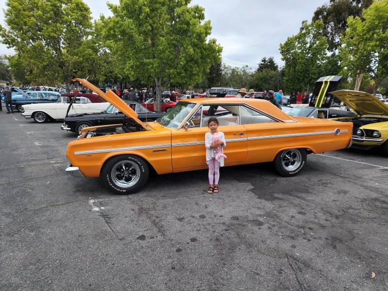

I've done a fair share of looking through posts on here, but wondering if you guys can help me out. My '66 needs a bit of help as far as the suspension goes. I have the front figured out, but I'm unsure of exactly what I'd like to do for the rear leafs. I'm leaning towards the ESPO springs, but idk if I want +1" or +2" over the stock height since I really don't know what the stock height looks like on my car. Right now it has pretty saggy leafs & air shocks. Whatever springs I decide to go with, I'm planning to use QA1 adjustable shocks. Can anyone post some.pics of their car with +1 or +2 springs?
Pics of the current stance for reference. I like a little rake, but I don't want the back abnoxiously high.
Looks great the way it is. Love the color
IMO I'd go with 1" over stock if you like a little rake. If its too high you can put blocks to lower it but 1" over I think will give you a nice stance. If no-one posts a picture of stock height then google your car and I'm sure you'll get multiple pictures of restored ones which would be height correct.
If you find someone whom has the correct height have them measure the middle of the wheel openings to the ground and compare that to yours.

In my experience, re-achring saggy leaf springs is a waste of money.They will be back to their worn out state in a year or so. Buy a new set from ESPO and be done with it. I would go with stock height, that would probably look like what you have now. Definitely wouldn't go +2".

Yeah, from what I've read, re-arching is not worth the cost savings. I'd rather do it right the 1st time and not have to deal with it in a year or so. I'm leaning towards +1", I'd prefer a little more rake than what I currently have.

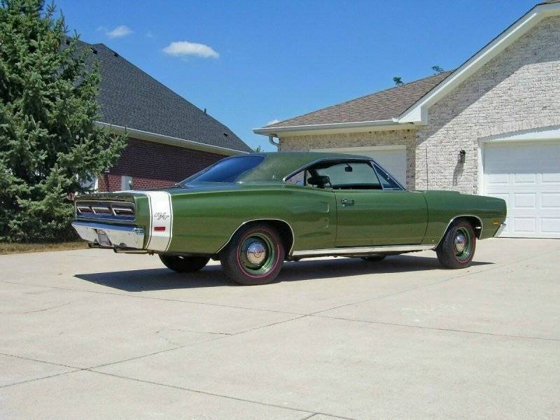

pic of stock ride height.
do the 1" or 2" over. easier to lower the back than raise it. re-arching works for a little while but eventually the springs settle back out; been there done that.
