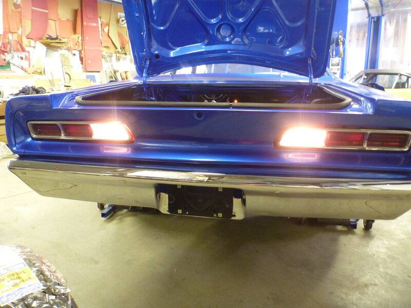

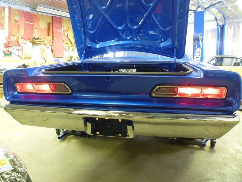

I used the Putco Plasma led bulbs for the taillights and back up lights, direct replacement and much brighter with less heat.
Putco on left, stock on right.
Not cheap but a definite improvement.

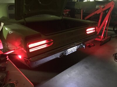

Made my own for my '69 Super Bee. Turned out much better than the aftermarket bulb type.
Tail lights - top is the stock incandescent bulbs, and bottom is the custom LED's. LED's are much brighter and fill the entire lense versus the stock bulbs.
Backup lights - Top right is the stock incandescent bulbs, bottom left is the LED's. LED's are again brighter and a little whiter than the stock bulb. (Higher Kelvin temp of the emitted light).
