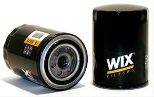

Part #51515 (for big blocks)
Simple. Done.
Yeah. Only reason I don't use that one is the filtration isn't as fine as the 51515...

I see, will pass bigger chunks, much higher flow rate.
A friend in the filter industry once told me, that they design (most) racing filters around the idea that the oil will be changed after every race/heat/pass or whatever and parts will be inspected more frequently...so it's preferable to have unfiltered oil as opposed to cleaner but lower-flowing oil. On some 'race' filters, and I don't know if WIX does it, but they open the bypass at a lower pressure differential (sooner) to keep restriction to a minimum.

Correct me if I'm wrong, but I believe the micron rating for the racing one is like 55?
I mean, they're both fantastic quality filters and I'd use either (probably have, in fact), but the last time
I was buying some on Summit, I got to reading specs and saw the difference in micron ratings.
Probably don't mean a thing on a street engine, really, but it caught my eye.
EDIT: I just looked it up and the 51515R filter actually is rated at 61 microns - and the description of the R filter is that it has heavier casing and internals.
Interestingly, both the 51515 and 51515R show a relief of 8-11 psi. You'd think there'd be a difference, eh?
