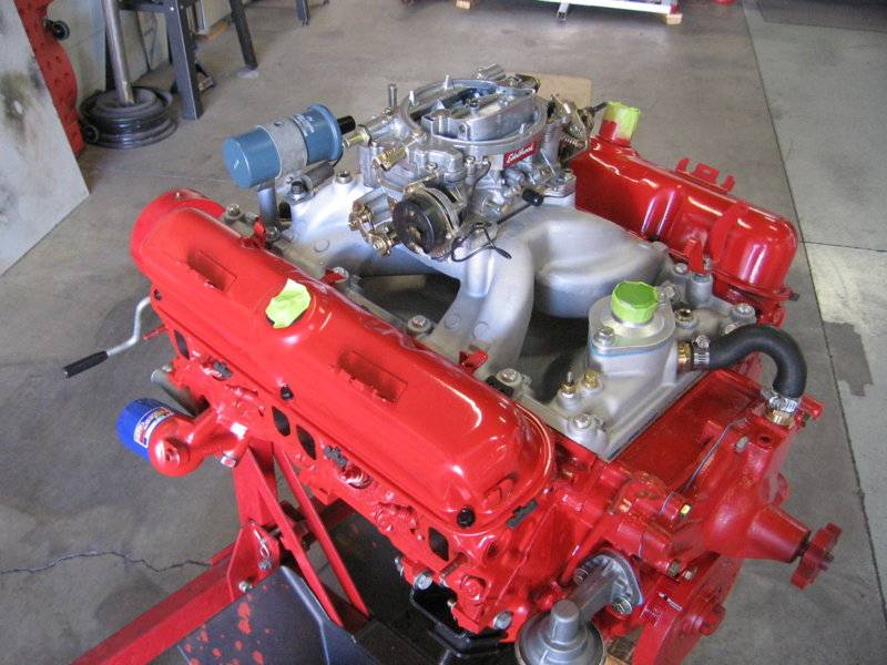

Photo of the 90*
I'll bet yours is straight because it a B body. A bodies had the 90*. But you never say never when it comes to Ma Mopar.

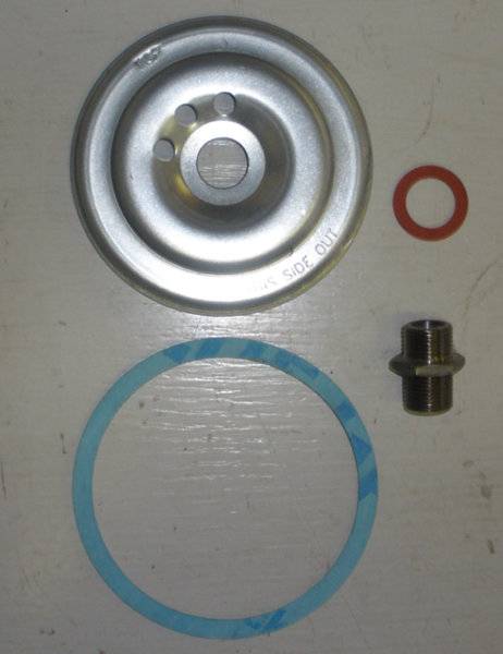

There is a gasket under the adapter plate. The plate is held on by a two sided threaded pipe with hex lands on the filter side. The adapter plate is lightly bell shaped, higher on the outside. Probably need a new gasket. If the fitting is overtightened, the raised center can pull in over time and cause a bad seal to the gasket. Crappy pic of mine below...
Stolen image from the interwebs...
