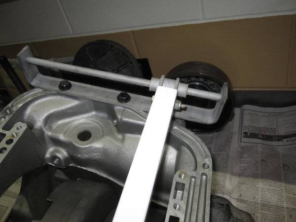

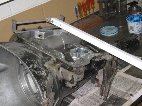

Hi Fellas,
As I mentioned in my "pig" removal thread, I'm not the man I used to be so I whipped up this servo compressor tool . Some of the return springs have a lot of tension (they can shoot all over the shop) so I needed some leverage help. This filled the need, just used scrap I had.
Mike
