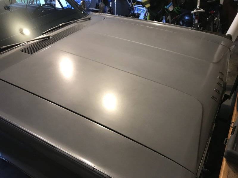

Thanks guys. It’s rained the last few days so I haven’t been able to get her outside to take good pictures, the garage doesn’t have the best lighting. I did wipe it down with a dry microfiber towel again and some smudging went away. It still looks dull but it’s difinetly smooth to the rest of the car. It doesn’t look as bad as it did Saturday and one of the 2 stain marks is quite faded now which is a good thing. I’m not touching it with wax I have again though. I’ll look at some of the stuff you guys recommended. More to come weather permitting.
Well, I finally went back at it today. When it’s all said and done, it’s a little better than before I started so I don’t feel too bad. I know the light isn’t fantastic but the rain didn’t let me pull it out. I tried a light polish, glaze and wax (all hand applied and safe for enamel). I will probably put another coat of wax on it this week but for now, one seemed to show me what I needed to see. You wont see your reflection but it doesn’t look as bad as it did last week. One thing to note, I am wondering if part of what I was fighting is old wax build up. The hood looks a tad more silver than the fenders I didn’t touch.
