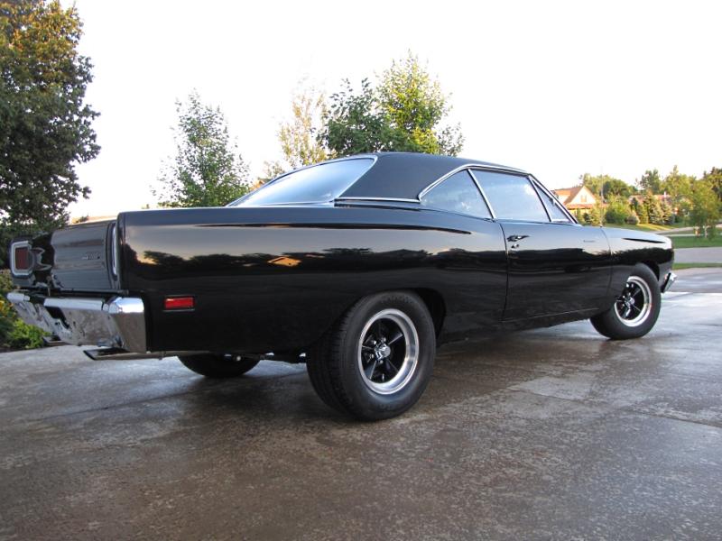

Everything else is correct on those wheels you're looking at except the backspacing. Rears should be 4.5" just like the bolt pattern as Prop says. EXCELLENT shot of the black RR by the way!
