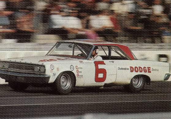

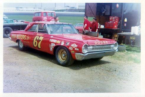

I have a '64 330 with stock suspension and I want to fill the wheel wells up with nice big deep-dish vintage nascar style wheels & tires. I measured what I think is a maximum of 4.5" backspacing in the wheel wells of the 330.
I've been doing a bit of searching around here and other places, and I'm finding that a lot of folks with the early b's are running 275/60/15 rears on 15x8's without issues, and up to 245/60/15's up front on 15x7's without issues. I wonder if those sizes are pretty much the accurate limit with stock suspension and no fender rolling/mini tubbing/etc.. or if even more can be fit in those wells.
Maybe a 15x10 rear even? or is that mini-tub territory? Fattest front wheel & tire without rubbing? do tell.
Is 4.5" backspacing the max or would more/less work for the deep dish theme? What about 16's? :)
