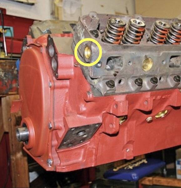

Don’t use any leak stop crap, it’ll plug your heater core. Have you checked the freeze plugs on the front of your heads, I had a leak there that I fixed.
