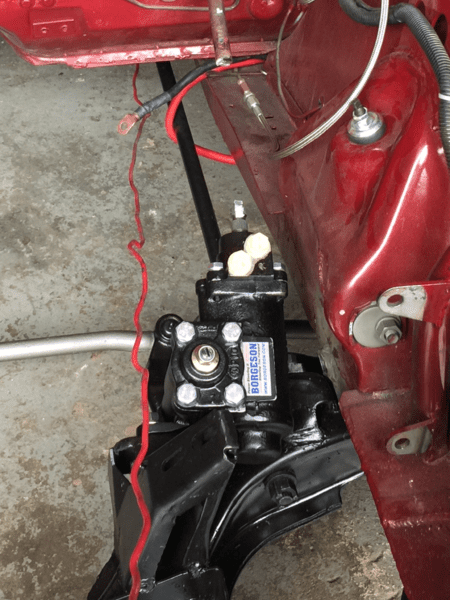

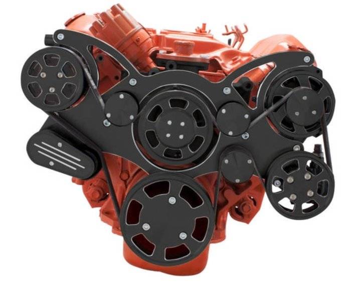

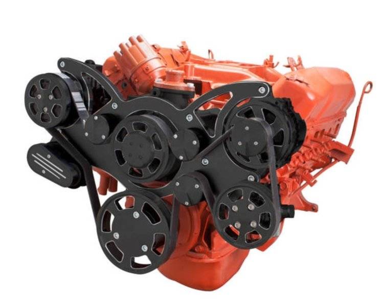

I am leaning toward the Borgeson, converting from manual to power steering once I get the Wraptor serpentine all inclusive system that I bought at Cruisin the Coast.
Also, is anyone using a Wraptor or another single belt serpentine system AND a vacuum pump?
Negotiated a good deal on the Wraptor, along with a bunch of other stuff we bought for my Roadrunner and my wife's GTO.
My concern is is there any "twitchy-ness" with the quicker ratio of the Borgeson?
Whatever box I get I would like to be as small and light as possible, and compatible with the "GM type 2" power steering pump on the Wraptor.
Any feedback is appreciated!
I posted the photo so you can see it’s relative size in the engine compartment I removed it because it’s a drag car that I will eventually sale
