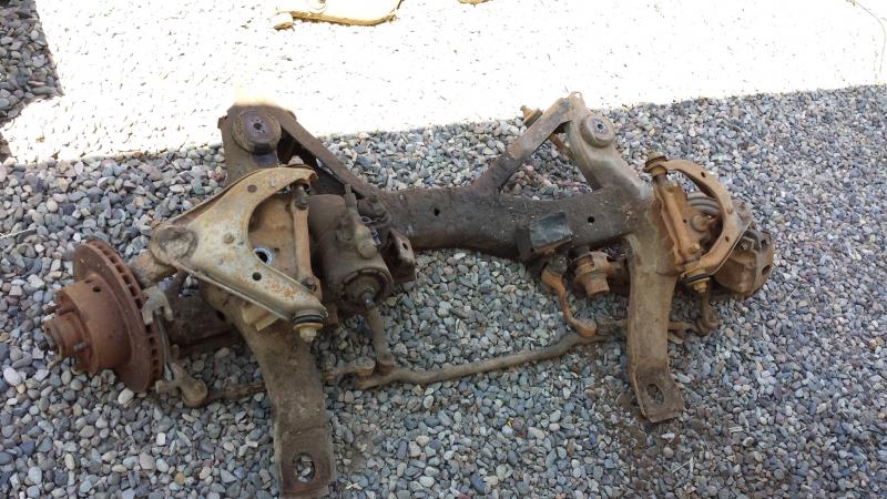

How much of a pain was it to remove the K frame?
Looks like the UCA mounts overlap the frame rails on both sides.
The brackets that holds the upper control arms bolts to the K-frame. Can remove them without removing the frame. Then replace the bushings and bolt back in.

ok, now wondering if these earlier production got diff K members too to SB and BB ????????
