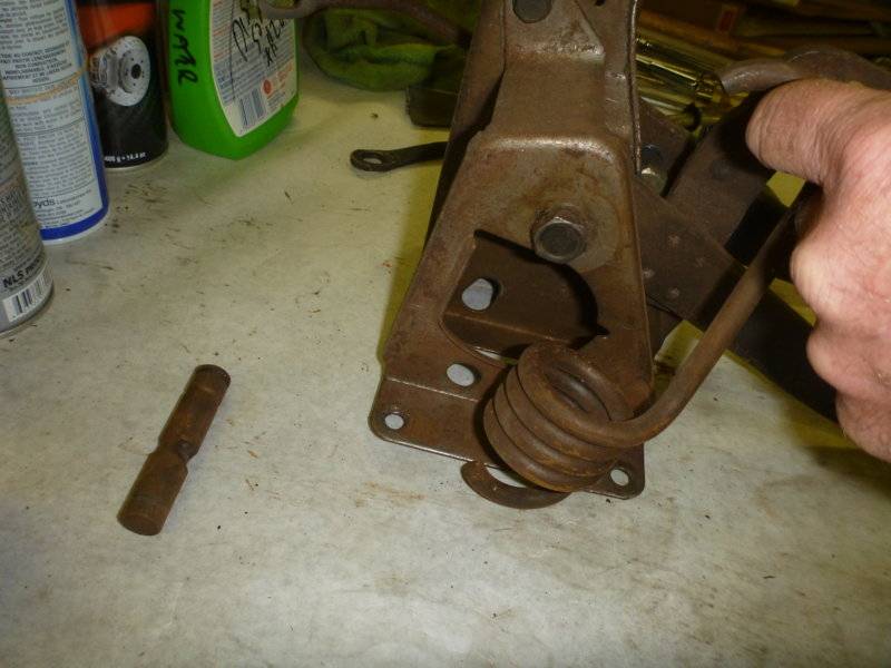

Unload the spring and the pin will come out. It's just retained with an undercut.
When on the car the pedal hits the floor before unloading the spring. Loosen the bolts holding the pedal assembly allowing the pedal to travel about another 1/2" or so and the this will unload the spring. Then remove the pin. Easy peasy. No blood, no pain.
