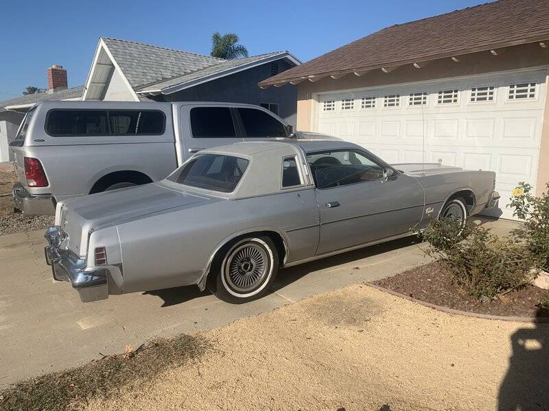

Just picked up my first Cordoba ever, it’s a 1977 and it’s it pretty good shape. Thinking about doing a a gen 3 hemi swap out of a newer Chrysler 300. I’m in California so I have to deal with emissions. Has anyone on here done a swap like this?

Great looking car. Love the silver. cool that it matches your truck. What motor does it currently have in it ?

I agree with you wholeheartedly, this car is so clean that it would be a great candidate. It’s even got the original blue plates
yeah it really is a great looking car. I may have to let it go if it gives me any issues during smog. It’s got a 360. I also thought the color was super cool. I recently got rid of a PT Cruiser GT convertible that was also silver.
