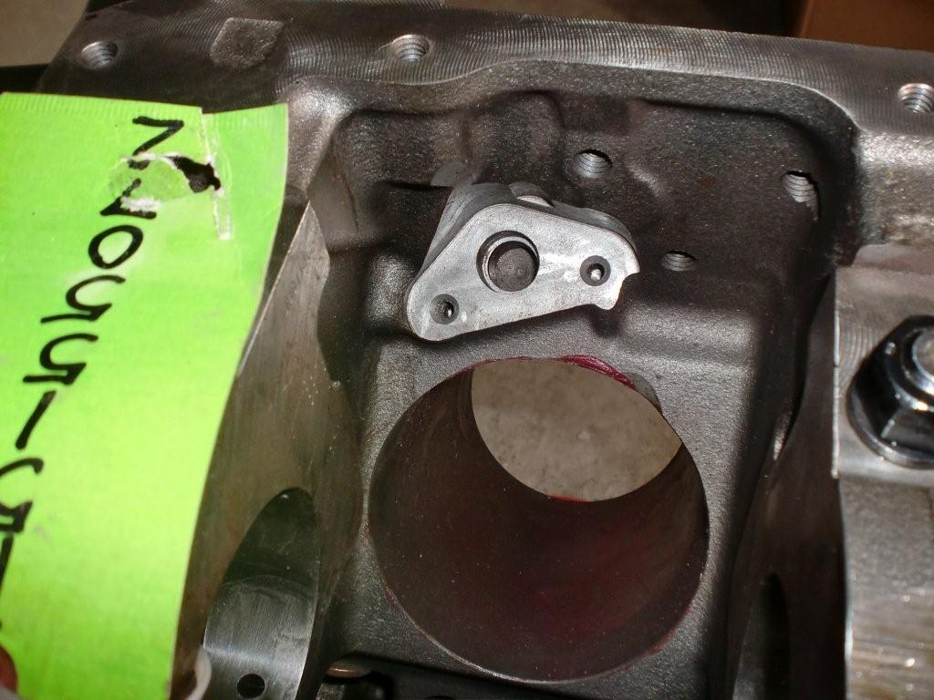

I bought block, heads and rockerassembly from a guy that changed his mind about his project so that's why I ended up building one instead of a crate.
Now, my block is a World/moparblock with casting# 5153843 and machined to
a P5155072 block.
1. This should mean 4.250" bore and honed? Pistons right in?
2. The oilpickup seems to be fastened with 2 bolts, where do I find a pickup like that?
3. The block is evidently prepared for an external oilsystem, is there a plugset
to buy since I want stock internal oilsetup?
