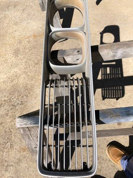

Guys, I hate to chunk an OEM grill that is useable if it can be "repaired"....any ideas of what material I could attempt a repair with. I do not have a salvage yard close by to select a piece of plastic from another busted grill of some sort.....any thoughts....
I’ve used Plast-Aid (EBay) for repairing plastic grills before with great success. For that missing section I would add masking tape to the grill to form the missing piece. The piece that you’re missing is small in comparison with what I’ve repaired in the past.
Not sure if you have cash on hand but there are a few for sale on feebay. If you're patient and artistic with a dremel, get a piece of fake(its actually plastic) wood at Home Depot and make a new piece for that gap. As mcodecuda stated, get some Plast-aid to glue it in and then use fine emery paper to sand down the seams.

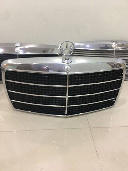

on my Dad's mercedes 1975 W116 grill I used a chunk of an old fan shroud to cut it to shape making several pieces. Then used a wire welder to blend those pieces to the original grill, sanded it then paint.

true... is a diff kind of plastic... but so far so good it worked for me. It was what I had in hands ( broken fan shroud ) and the thickness was pretty much the same than the grill sections. Sure the Mercedes grill could not be that critic to use diff plastic because did need small pieces.
Just need to restore a 4 squares plastic section and then painted ( not my grill on pic but for those who doesn't know the grill ), so just need to make a cross shaped piece to fit into a hole. It came out really nice

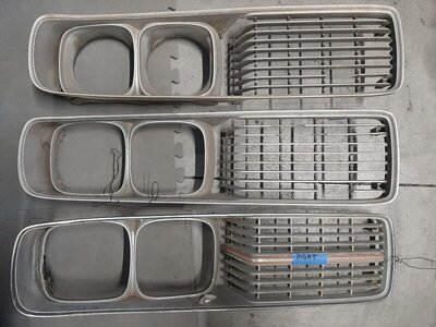

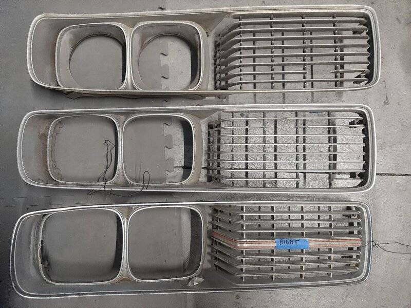

I too have been following this topic with interest. As you can see in my attached photo, I have 3 passenger side grilles needing repair. The bottom one has a chunk missing on the side of the outer headlight. The top one is missing one bar and the center grille is missing 3 bars. I was thinking of using bar pieces from the bottom (SE?) grille to repair the other two. I hadn't heard of Plastex either but I could use it as the glue to put the bars in the top two grilles. Is sacrificing the one grille to save the other two the way to go? Thanks for your ideas and suggestions.
Terry
Well Terry , back in the day we would do that, bust up one to fix another. I would turn a car over just to dump the motor out. But your 50 year old pieces get more valuable each year. While they are repoping these , many prefer original if possible. So, I think all yours are repairable and would be of some value. I try to fix the easiest one first....and that will tell you whats needed for the other ones. Heck, if you don t want to fix it, just buy the Dodge emblem use on 71 -72s front grills and attach it over the busted spot....would be unique any way.....
JB Weld works good as an adhesive and patch.
It's also close to the same color.
McMaster Carr sells ABS plastic in bars and sheets of different thicknesses. They sell it by the foot and it's a reasonable price. I thought about buying some in the correct thickness and repairing them. I have 3 grille sets with no broken pieces so these are spares to my spares. I really appreciate the input. I'll let you know how it turns out. This is a fill in winter project.
Terry
