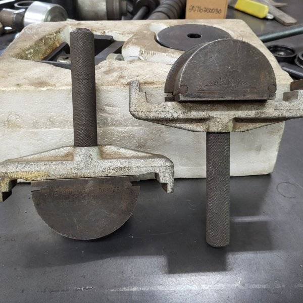

Any old timers recognize this tool?

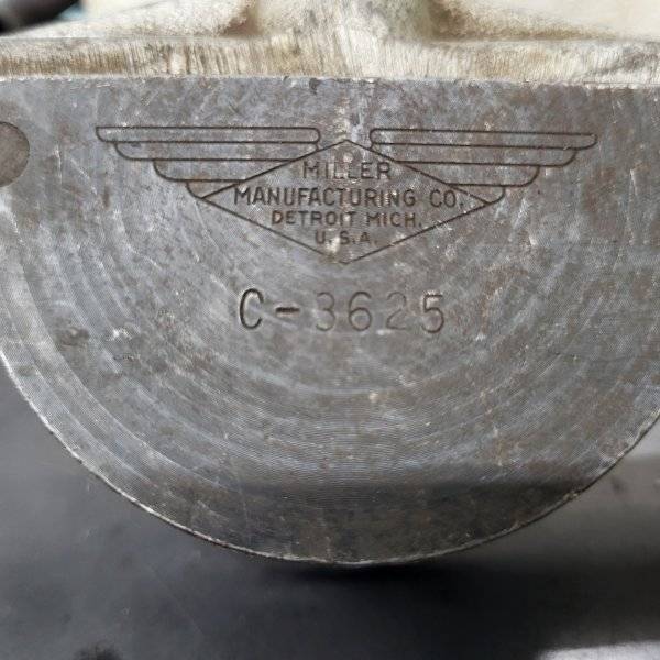

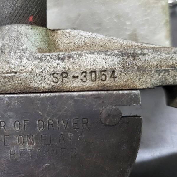

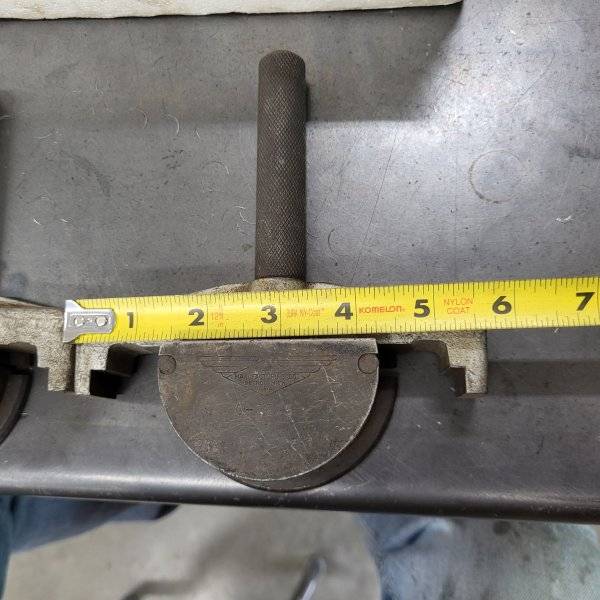

Got a bunch of old Miller tools out of a Chrysler dealership. Most #'s pop up on the web, but not these. Could it have been used for setting the old rope rear main seals?
Thanks guys. Wall art, or do they have any value?
