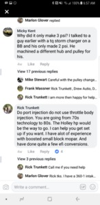

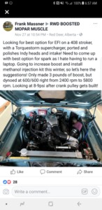

The head units are too small for the applications they are being sold for. If you have a big block or decent flowing heads they just aren't efficient enough. They only flow about 1100 CFM where a Procharger P1SC flows about 1250... and a P1 is considered too small for a big block.
Their claim of 6-8 psi is B.S.a lot of guys that have purchased are only getting 2-3 psi and talking about machining other pulleys but these little head units are maxed out and just going to over spin. This is why if you look at their site and Sema they are doing several twin supercharger setups because that's the only way they can put down a half add respectable number.
