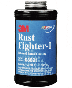

Another real good option after everything is welded up and coated, is use a under panel coating like 3M Rustfighter or Rustfighter II. You twist the bottle onto a standard body schutz gun, use a flexible 3' long flexible wand and spray it in any nook and cranny you can get it in (like frame rails, extension panels, rockers ect..ect...). It has the consistency of petroleum jelly, never dries and is an excellent moisture barrier. I know several high end resto/body shops that exclusively use it.
Propwash, I agree. Another option would be fluid film with the same type of 360* wand. Yet another option is Raptor bedliner sprayed with a wand. One thing to remember is that our cars will most likely not see the winters and rain like they did when they were new. Anything will be better than nothing!
