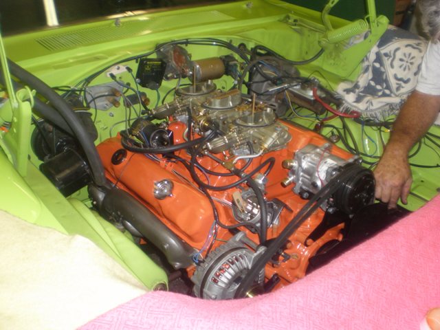

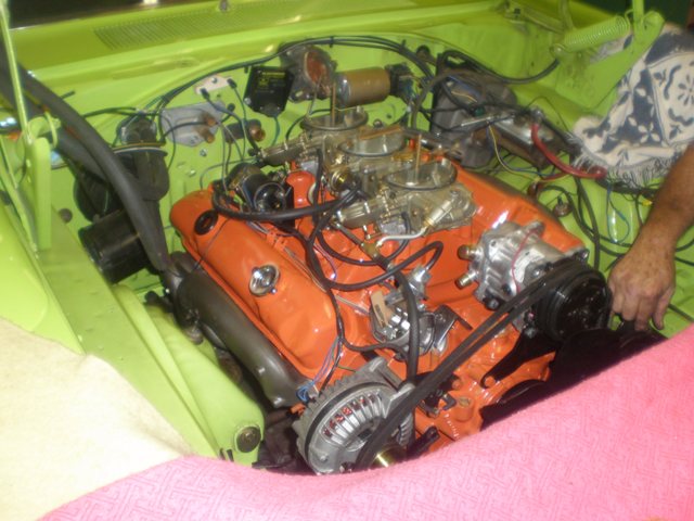

my super bird convert has a six pac motor the carb are newly remanned by holley
I am having vacuum problems ,( not stopping brakes?weak
we figured out the vacuum sec's are opening really quick and sucking off all my vaccuum on #1 and 3 carb .When at low start up speep when the center carb is all that shoud be working ? Any help ?
Have you checked to make sure the vacuum lines for the carbs are hooked up properly? Also, what cam are you running? Any idea of how much vacuum it's pulling at idle? There are also different springs for the vacuum pods like for a Holley 4V. Any idea what is in your carbs?
vacuum is poor yes because it's a big cam , but there are fresh holley rebuilt by holley, With i assume stock springs , do i need stiffer springs. The problem is i have weak vacuum already and with the secondarys opening up as soon as i hit the gas pedal ,that sucks off all my vaccuum. They should open up at speed when i need the other two carb right ?
Big cams and six packs don't mix well without a lot of work. You would need heavy springs to slow them down. If it were me, I'd ditch whatever you have in there in favor of a stock cam, or at least one of Bob's "blueprinted" cams. With sticky tires it's enough to take you to low 12's, and no problems with vacuum either.

I just took a look at the engine pics again. With manifolds you really shouldn't be running a stupid big cam anyway. Motor won't breath right. But as I said before...knock yourself out
How big is the cam? Is the timing in the tailpipe? What's the compression ratio? I'd say 220 deg @ 050" is plenty and 112 deg lobe separation. Hmmmm, factory magnum cam sounds about right.
