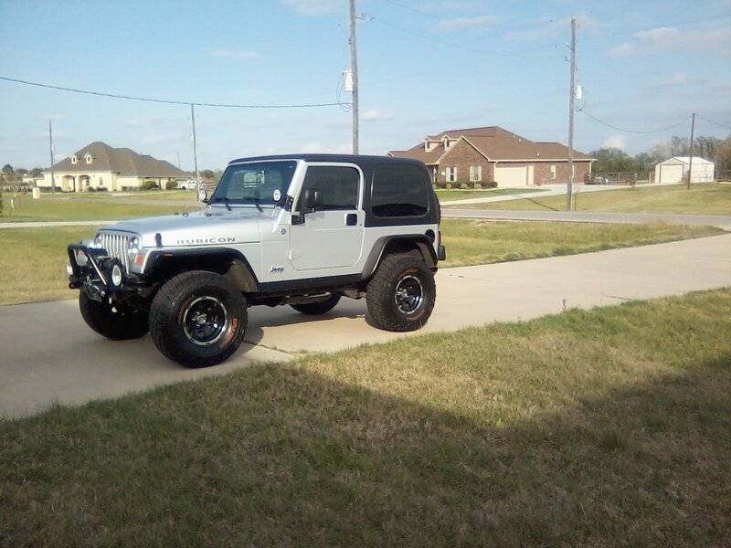

I ran a 10K Warn on a Jeep Rubicon for many
years. It never failed. Switched the steel cable
for a Dynema 10K rope after seeing a winch
hook smash thru a fellow 4-wheelers' windshield
after his cable broke. I've also seen a few hands
get sliced from steel cable strands. Ropes take
a little extra care as to not pull over any sharp
edges.
With a 10K winch and a snatch block, you can
double your pulling power.
