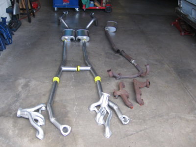

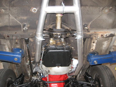

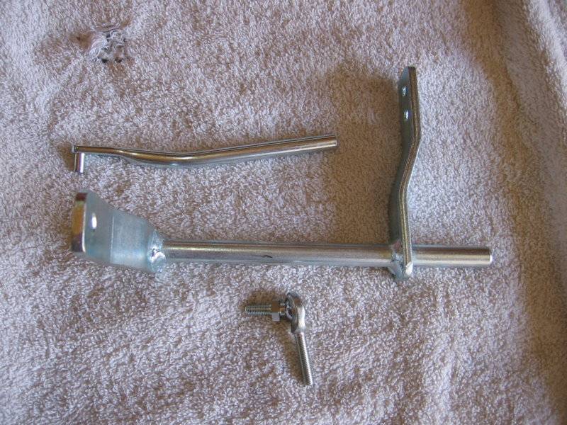

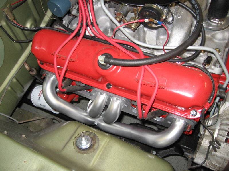

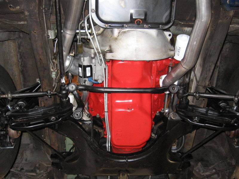

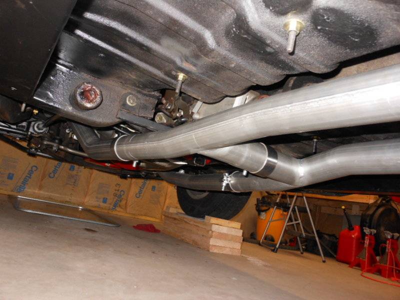

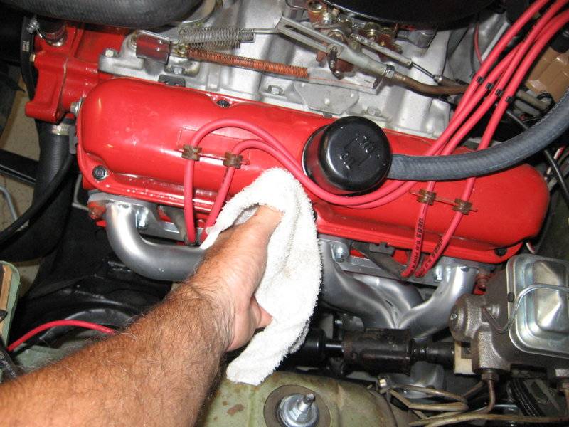

Yes on the TTI's. The easiest headers I've ever installed. If you do go with the TTI shorty's you will need the down pipes to attach to your current exhaust or get the complete system.These photo's are from a 68 Valiant that we did.TTI also has a kit(photo) to do a changeover for column shift cars,or you can modify what you have.
I do, but not the best (it was windy) sound bite.Having trouble finding what I did with it. The car was a 273 with a Jegs #555-200161 cam kit.904 with a 2.76 rear. The car was built as just a driver/fun cruiser. I have installed many of the TTI header kits over the years(long tube) and wanted to try out the shorty's.After removing the stock exhaust it took a total of 10 minutes to have the headers in place and bolted down.No lie.Passenger side from the top and driver side from underneath.

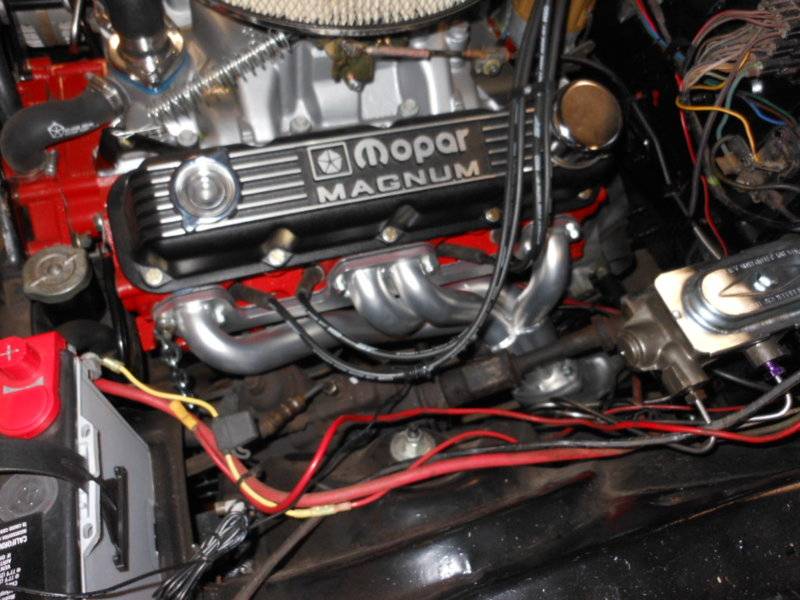

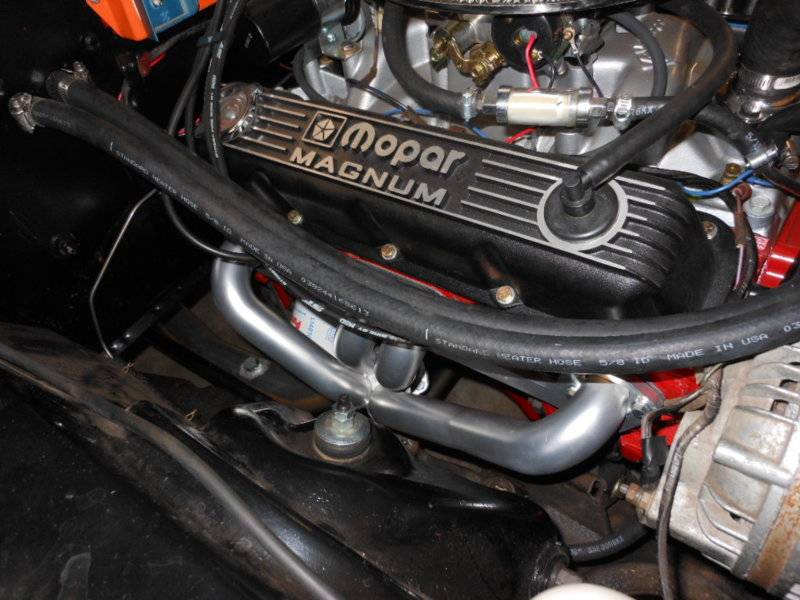

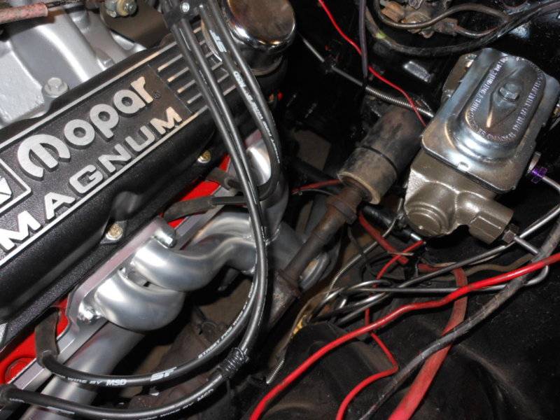

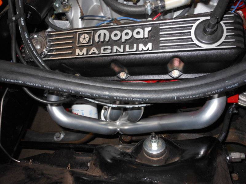

Here's the TTI shorties in a 67 Belvedere, but with a 4 speed. Very easy to install. The driver side adapter pipe was a little tricky to install without pulling the torsion bar but I got it in. Switching from small port manifolds it was a noticeable increase in power, especially once the carb was re-jetted.
