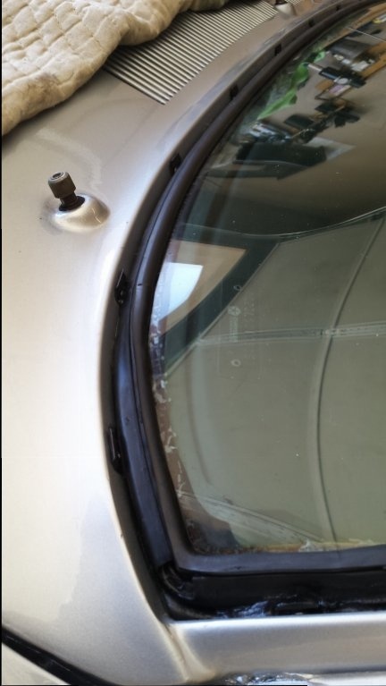

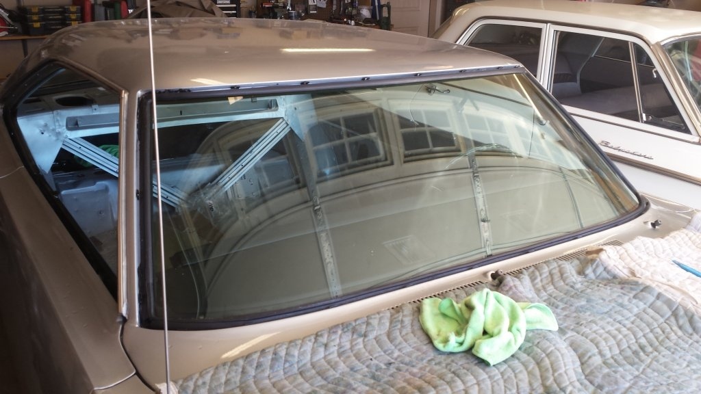

I installed mine (1969 GTX) by myself and not at any point was I worried it was going to break. I used the locking gasket by AMD as I found it on Amazon for a good price.

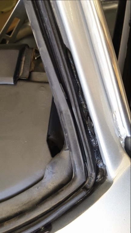

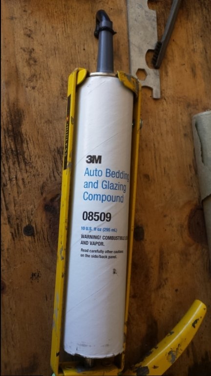

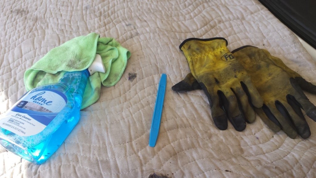

You will need one, preferably 2 windshield install sticks. Just tapered plastic sticks. Windex, 3m 08509 Automotive Glazing and Bedding Compound (comes in a caulk tube).

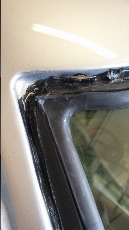

Use the glazing compound along the entire bottom run of the windshield channel and up the sides 6", also on the L and R upper corners.

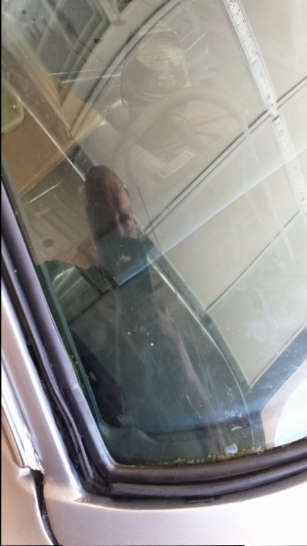

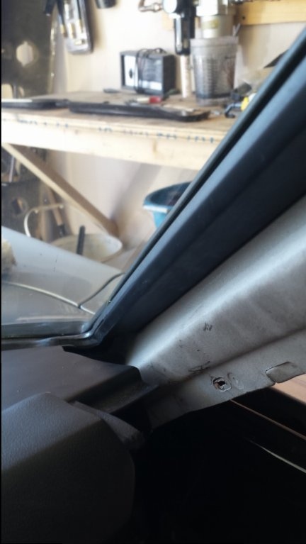

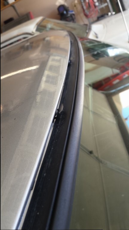

Set the gasket in place. It lays in the lower channel and fits over the pinchweld on the left, right and top. Set the windshield in the lower gasket, get it in the channel, hose down the rubber with the windex so it slides easier and work the outer seal lip over the window. Work up one side and over the the other. The top corners are the tough part but keep working it until it drops in using the plastic sticks.
The lockstrip was the easiest part. The inside lip tucks into the outside lip.
We just did my Brother in laws. I can verify all of threewoods comments. Follow he advise he knows what he is talking about. Also at no point was I scared the glass would break. Only tip I could add is to tape the gasket at the top just to hold it till you get to that point of working it in at the top.
Thanks for those tips and pics on the windshield install.
