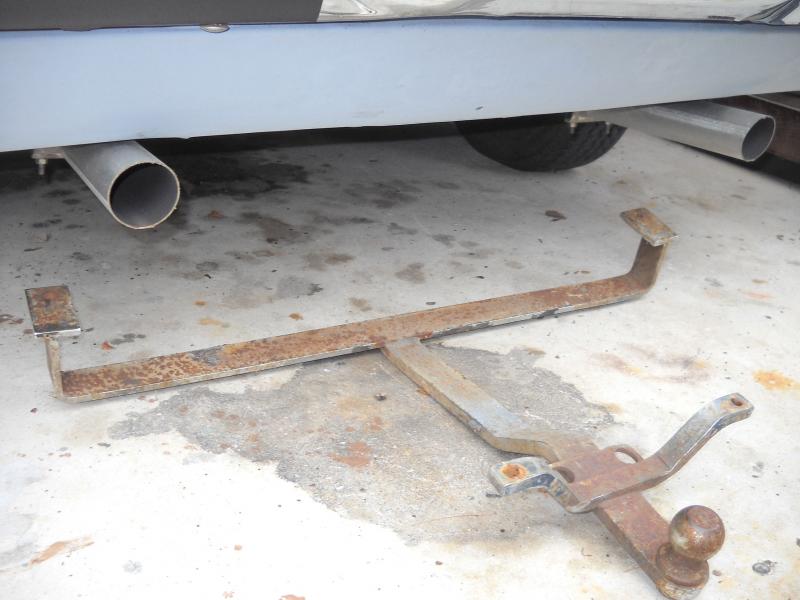

That's the hitch I need!
There was one at a local JY, but I couldn't break the welds on the frame, and the car was gone the next time I was there.
I have the ball end off one that someone cut right behind the chain loops...
