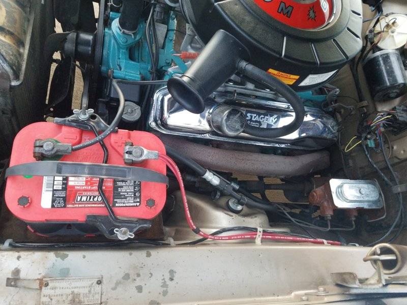

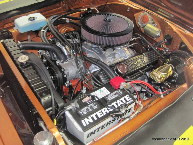

I had cables made for my daily driver for a custom installation.
If you want a correct restoration don't use these cables. There are vendors that sell an accurate re-popped cable but they are pricey.
Here is my '67 Coronet,I bought the positive cable from M & H electric,these guys make really nice stuff! The ground cable is a generic part.
