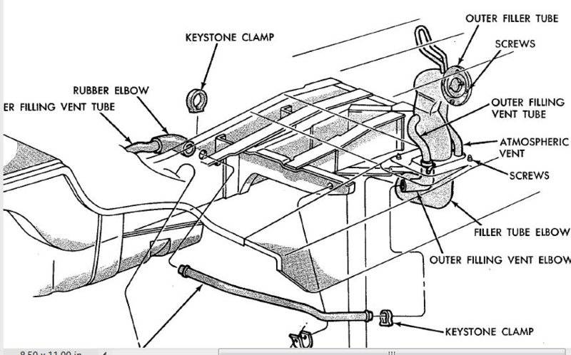

    There are 2 rubber elbows I'd check those. There's a rubber grommet where vent tube goes into tank. Mine weeps if I top off tank. Did you use your old lock ring when you did sending unit? The old ones work best, if you got a thin one. Could the fuel run on the lip of tank to driver side and fool you that its from the vent?

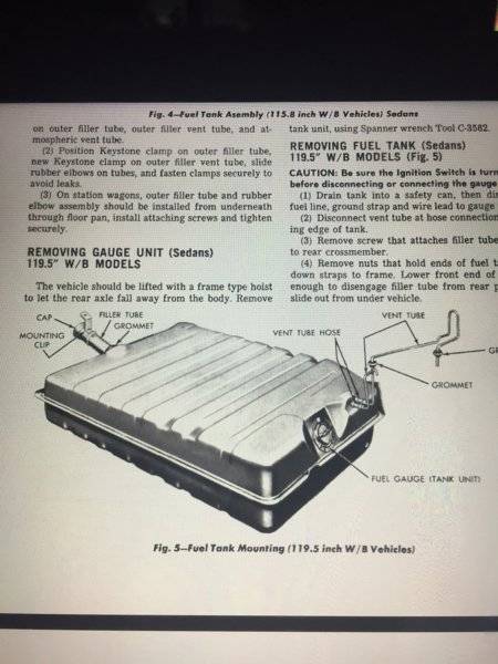

            Its been awhile since I messed around with that small line. Is it possible that it rusted out down low? Have a fill tube in my garage if I find it? I'll have a look. Gas tank.JPG

              That's not my configuration, mine is like this:
              Note the 2 vent tubes, long one goes up into trunk, next to it is the short "suspect"

              Duh! Dumb I should have looked at your avatar. Had it in my you had a 66. This happens to often, not so much here but to often.
