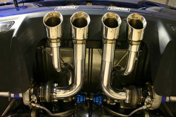

I was a big boost nut aswell, owning many Eagle talons from FWD turbo auto to AWD turbo 5 spd, I still have the AWD car, just couldn't let it go :) I've been collecting parts to build a rear mount turbo setup on my stroked 440 Sundance (thats why I used Forged pistons) Any way very interesting topic!!

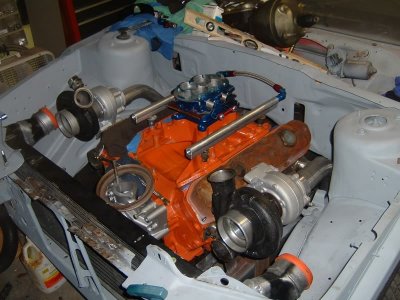

Found a pic you might like to see.
Interesting... that looks just like a draw-through set up I was imagining I could build. I wonder if they made that. Only problem is no intercooler... but maybe much easier to tune then trying to set up a blow-through carb. Maybe some sort of air-water intercooler would fit in there somehow.
Hey 74Sundance... I have heard of doing rear mount turbos, I saw pics of an older camero done that way. What would you do to minimize all the lag due to that much pipe having to pressurise in both directions? Would that be best for just racing or do you think it could be done streetable?

I had thought that there would be lots of lag as well but they claim there is not..but I guess we won't really know until we try it :)....If you think of it like a garden hose open ended the water pours out but if you close the end off a little it shoots out like crazy..Same idea with the rear mount you need to have the pipe reduced in size to increase the pressure and reduce the lag.
I think with V8 the lag wouldn't be a big deal,plus you need to think of all the good there is in having the turbo in the rear,no muffler, fresh cool air into the turbo, no intercooler needed,no added heat in the engine bay from the turbo,oh and dont for get the cool factor.
