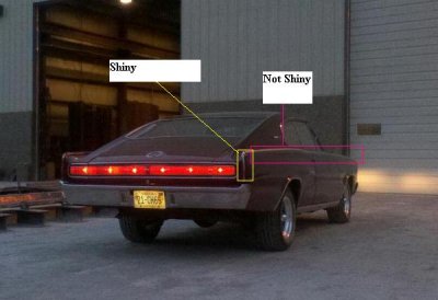

Im thinking about buffing the trim railing that runs basically along the top of the fender all the way to the back of the car. The previous owner had the very back two pieces re chromed, but never buffed the long pieces that connect to them so it looks kinda funny with the back piece shiny then the rest of the way its dull.
Here

The ridge trim that runs along the top of the car was originally anodized aluminum. Most people have the anodizing stripped off and just have the aluminum polished. Chrysler put the anodizing on it since the cars would be subject to the weather. I just had mine stripped and polished for my 67 restoration project and it ends up looking like chrome. As long as you keep a coat of wax on it from time to time and don't keep the car outside and subject to lots of rain/snow/ice storms, it will last for a long time. I paid 9.00 a foot to have mine done in NY two years ago, The guy also took out minor dents and scratches....the two pieces you pointed to as shiny are the "J" chromes (on the horizontal rear section of each fender) and are supossed to be chrome plated.

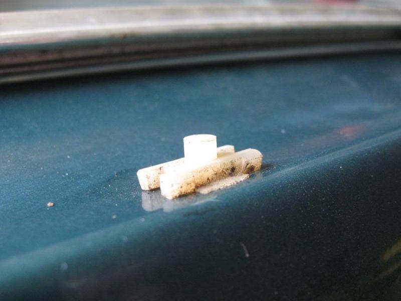

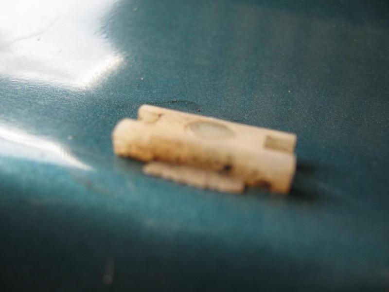

The fender mldgs are bolted in the front and rear and have plastic clips in the middle. Once the nuts are removed the trim can be carefully pried off.
The clips for the fenders look like this.
The center pin gets pushed in and that locks the clip to the fender.
Qtrs are a combination of bolts and metal clips that clip on to the qtr seam. Maybe someone will have some pics.

Does anyone make the clips that hold this trim on?I need at least 1 so far.
I need at least one plastic so far.I didn't know if anyone repo's these or not.
