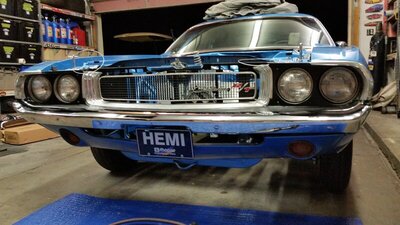

I thought about the wrap or the newer chrome sprays. Since mine is street driven I choose repro AMD bumpers. Fit and finish were great. I guess I don't have a shot of the rear view. Everyone else gets to see the tail lights. Lol.
