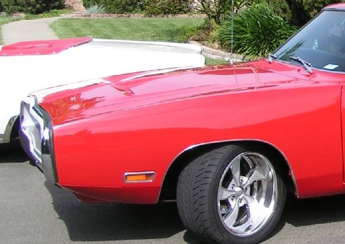

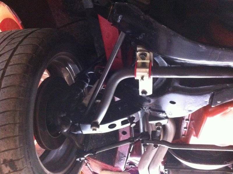

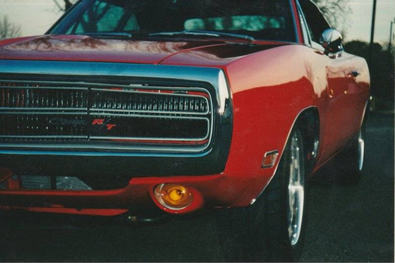

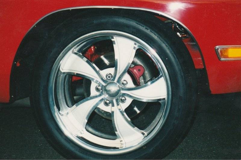

I have 18x9 wheels on the front of my 70 Charger...
My situation may be different though. The larger diameter allows me to tuck the wheel inside the body more, allowing the outer tie rod to sit above and inside the rim edge. Not so with a smaller diameter wheel.
EDIT: Looking at that last picture, it looks like the tie rod end is not inside the wheel edge as I thought....Maybe you could still have an 8 or 9 inch wheel in there, you just need to choose the back spacing correctly. Mine are centered or close to it at 4 3/4" as measured from the mounting surface to the inner rim edge.

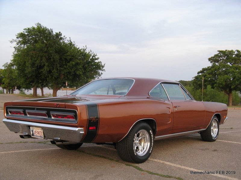

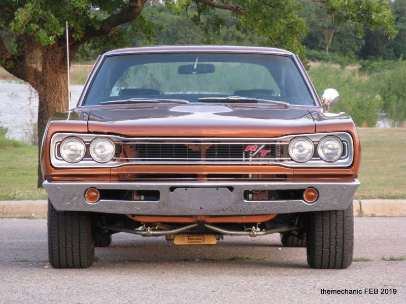

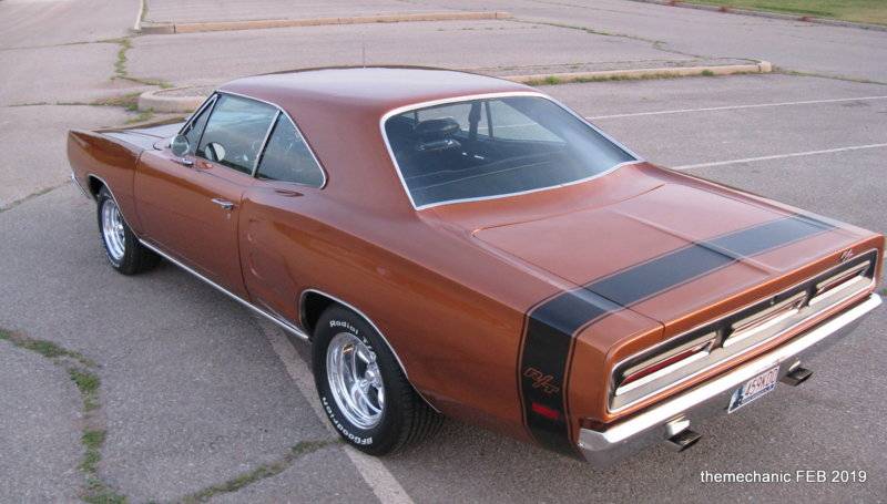

I'm running 245/60 x 15 x8 with a 4.375 back set on the front of my 1970RR.These line up with the 295/50/x 15 in the rear. Handles very well at 90-100mph

Hey '69 themechanic or others,
What back spacing are you running on the rear tires if any.
I want to run 295/50/x 15's on the rear of my 69 Coronet RT with Magnum 500 wheels...15 X 8 or 15 X 10. What does anyone have to offer for advice or experience?
I ended up installing 15x8 all around with 235/60/15 tires. There is a ton of room in the back with 4.5 offset. With close to 3 inches to spare before tires touch leaf springs. Not so much in the front. Same rim and tire is about 1 inch from touching the lower control arm/tie rod.
I have 18x9 wheels on the front of my 70 Charger...View attachment 721817View attachment 721818
