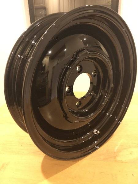

To break the news, I now have probably the first pair of Bogarts "Steel" look alike aluminum wheels that weighs 17 Lbs bare. Attached below.
I want to check if that number makes the wheel worth while against a real steel wheel.

I have weight figures for centerline auto drag 15" x 3-1/2" at 11-3/4 Lbs for a bare rim. Depending on the tires make and style over all total weights may vary.

A centerline auto drag 15" x 8" in which I now run with a special hub cap to make it seem like a stock steel wheel comes in at 14-1/2" Lbs for the bare rim.
In this thread, I am trying to get to the bottom of what I think might be a mistake on my part as to the weight of the old steel 15" X 3"-4" wheels. I want to compare my new aluminum STEEL look-alike wheel to those numbers. Yes I am still on a quest for weight reduction during the Winter months. Just look up my couple of feature articles in both Mopar Action and Mopar Muscle under the headings: "Let there be light" and "Light is might" or just google "the worlds lightest all metal B-body.
