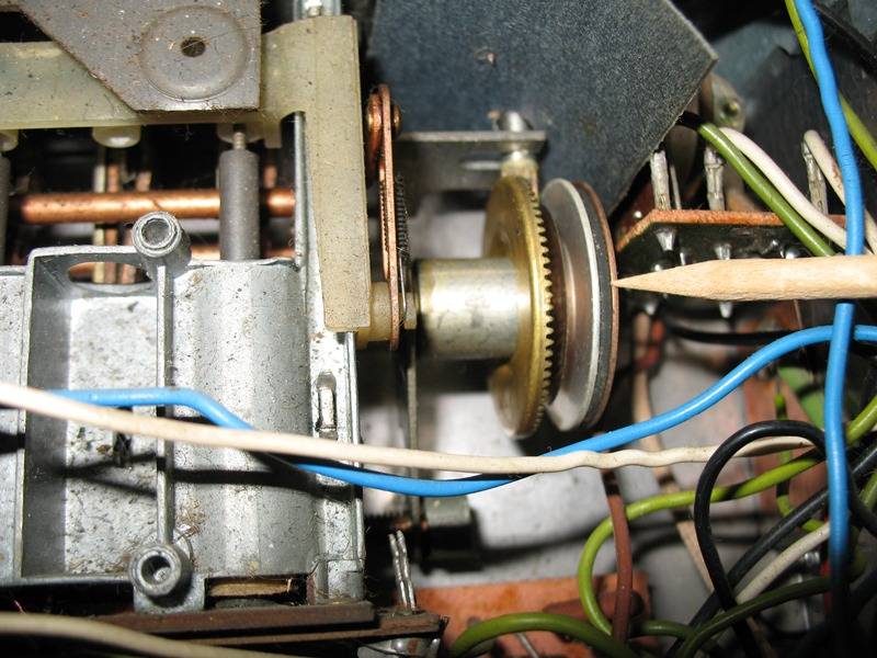

First pic. This is the plate you must take off. The two small bolts at the bottom are inset, and hard to reach. I took a Hex bit holder and ground it down to get them out.
Second pic. This axle must be taken out. You can only push it towards the thumbwheels on the other side.
Third pic. Axle out, then thumbwheels come out. In the middle of the wheel on the right you can see the little white plastic beveled gear that often breaks.
Fourth pic. This other gear, when turned, moves the dial pointer back and forth.

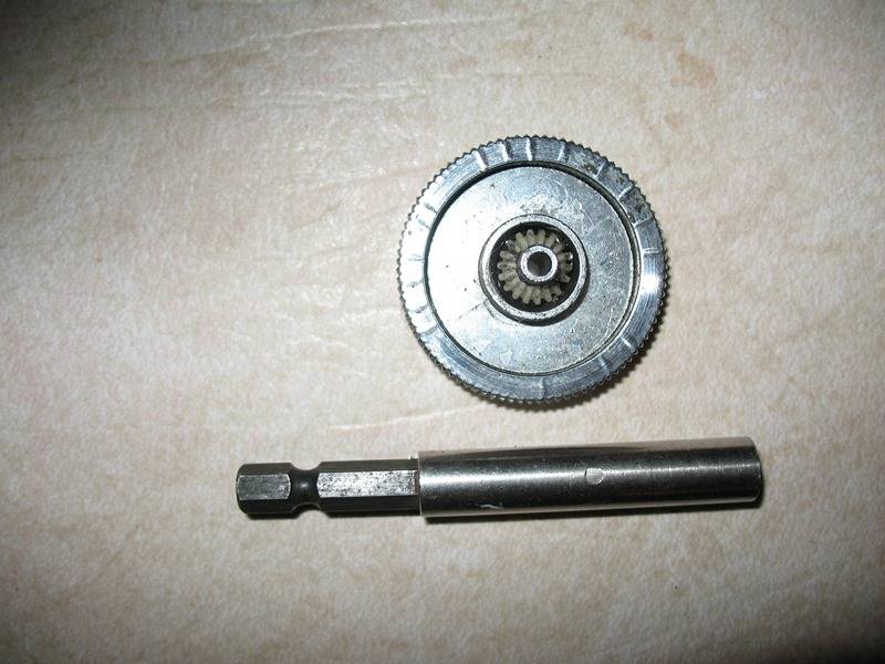

This is the type of magnetic bit holder I am talking about. Grind down the diameter of the end that the bit goes in. About an inch. After it is ground down to the point it will fit into the recessed area the small bolt is in, just use it with one of the drivers that you put the small hex bits in. It is the correct size for the bolt. Here is another view of the gear attached to the tuning wheel that often either cracks or comes loose from the wheel. Can easily be glued, just don't get glue on the teeth.

I am confused by this statement. What are you referring to as the tuning wheel? If you are talking about the thumbwheel, the tuning thumbwheel should have absolutely no effect on the dial pointer when a pushbutton is in. Before you disassemble the front, take off the top cover of the radio. While one pushbutton is pushed in, turn the tuning thumbwheel. If the gear I am pointing to in the first picture turns with very little effort on the thumbwheel, the gears and thumbwheel are probably ok. If it doesn't turn, that little gear on the thumbwheel is probably broken. If that checks good, pull that gear toward the middle of the radio. that will disengage the clutch. Try to turn the wheel I am pointing to in the second picture. It should turn easily, and as it turns the dial pointer will move. By finding out which of these tests takes excessive force to accomplish, this should tell you if your problem is before or after the clutch. An appropriate fix can then be made based on which test shows a problem.

Okay, I took it apart, and the gear is still attached to the thumbwheel, but there is one crack in the gear, which is good because it still has a lot of integrety, but bad because the crack is very tiny and trying to glue it is going to be tough.
