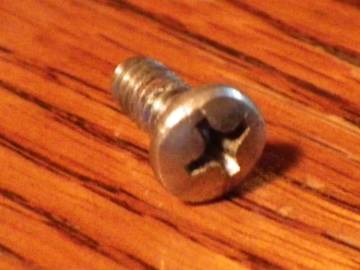

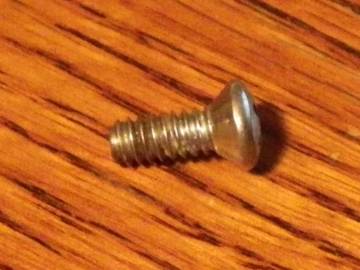

Also I noticed I was missing a couple of screws and I'm thinking it might have allowed excess flexing. I was missing one on each side (there should be a total of 6). Any idea where I can get some? I'll try to post a pic later.
Well, sanded, painted the wing. looks good. re-attached, but still need a screw. I miscounted before, and I am missing one.

Cant tell the size from here but a door latch screw may work. Change them all if the head is different. Look for a trim paint that has self etching properties. Clean it with a plastic prep or soap and water. SEM products are awesome if not budget minded. Solvents may soften the plastic or bring contaminents to the surface so be careful. Red or gray skotchbrite to sand. Boss did his in Sikkens Rally Black and it looked good.
