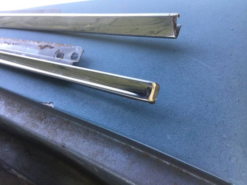

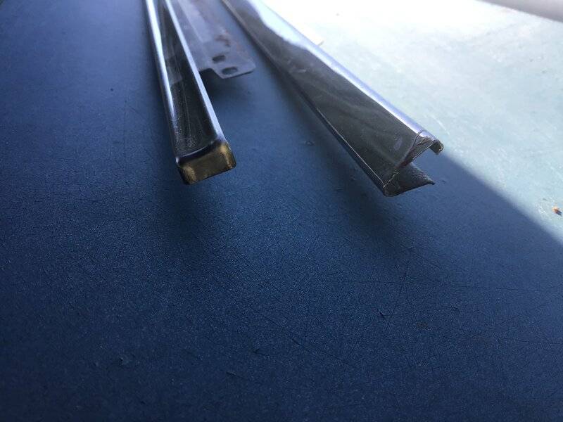

Found some nice Interior stainless door panel divider trim. It looks like 66-7 B-body or could be A-body? It measures 41 1/4 on the doors and 24 7/8 inches on the rear qtr. pieces... Any help is appreciated.. As always Thanks in advance.
A & B body are different shape. B body trim is the same 66-70.
B body Rear 30.5” and Front 39.5”
A body rears 25 7/8”. ******Nope it is 24 7/8”******
A on left B on right in photo

Thank you so much. I knew about the shape but for some reason I had in my head it was 68-70 B was more round and 66-7 were like the A body just different lengths.. Again Thanks!!:thumbsup:
Typo? A-body rear 24 7/8???
