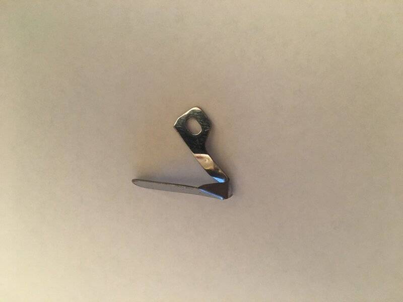

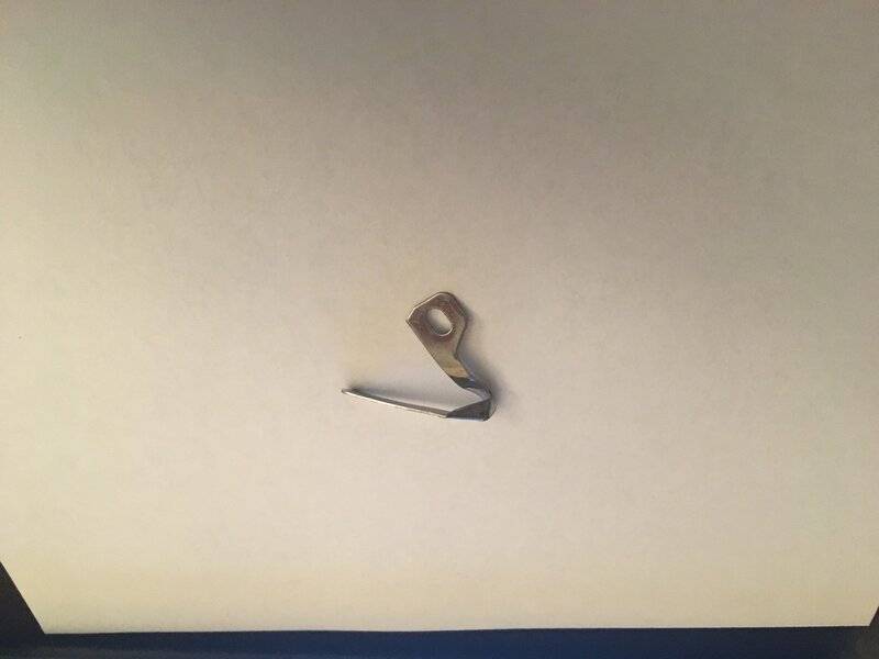

I believe that these are for the outside stainless steel trim between the "A" Pillar and the vent window but I am not sure. They definitely have a left and a right to them.
Thank you as always.

66-70 b-body all cars. They slide in the end of the bottom windshield trim. Screw retains it to the cowl area. Only seen with door open.
Thank you for the response. Have not yet been able to figure out how. Will keep trying.

Pic of mine taken during disassembly. Slides into the lower windshield trim piece and screws into the door jamb just below the end of the drip rail. Strangely my car only had one on the passenger side. The driver's side wasn't even drilled for one...
Thank you this helps. I still cannot find the holes which is most likely due to the body filler that was put on by someone else. They covered all the holes.
