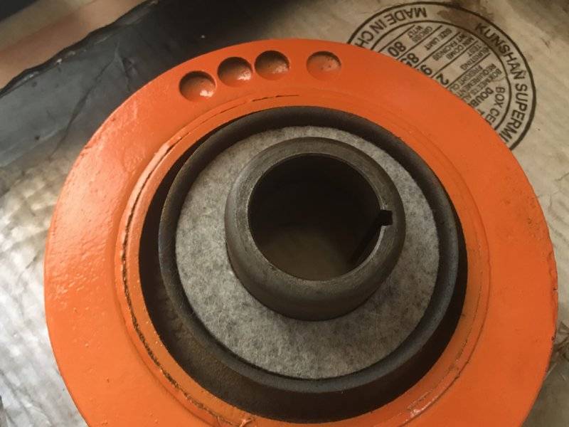

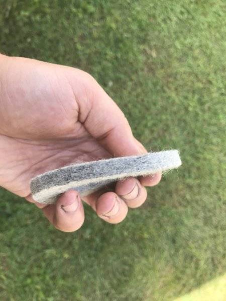

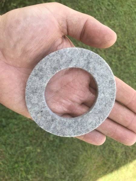

Last night I started to reassemble my timing cover, gaskets, etc on a small block 360. This was included in the Felpro timing cover gasket kit. It’s made of some kind of wool. This wasn’t anywhere to be found as far as an old one when I disassembled everything. I have no clue ?
D4EAAC04-2B75-4457-9035-5DC0C58A8439.jpeg 591711DA-2A74-430C-BE7F-5819FFC8BCA9.jpeg
It goes on the harmonic balancer. It fits over the hub and into the dust shield...
Looks like something that helps the mechanic with his "10 mile, 10 minute guarantee". :bananadance:
Thank you, is this right ? Just sits in there dry ? Seems kind of worthless, not one on there when I took it off.
