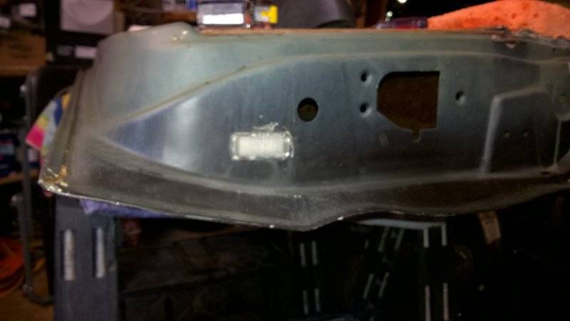

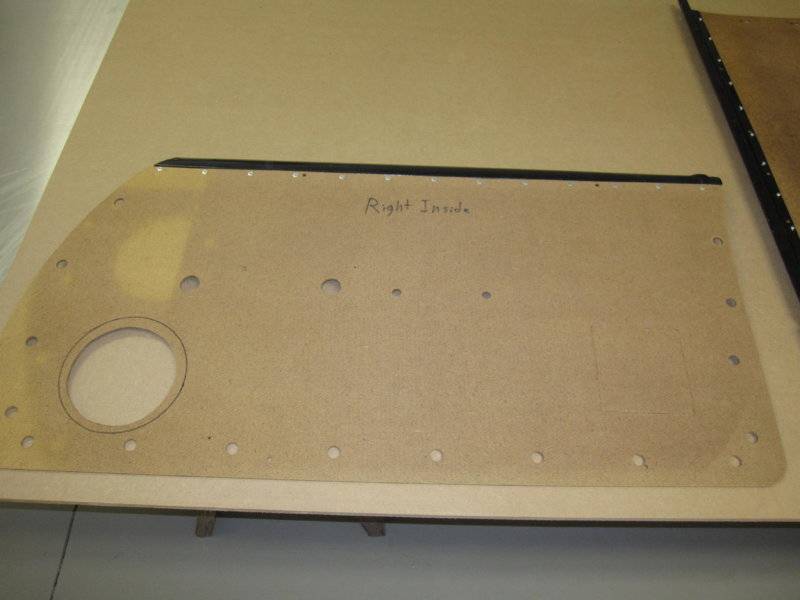

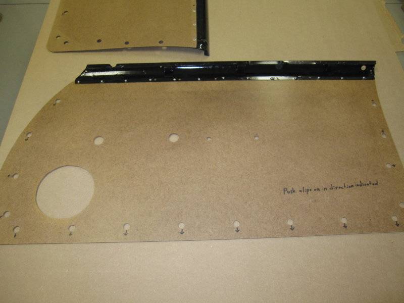

I made 4 new panels for my 65 Belvedere using 1/8" Masonite board. When it came to the rectangular panel clip holes I took note of the clip installation direction and used round holes for the clips as they were much easier to form. I also pop riveted the Masonite to the curved steel top pieces (originals were stapled). The sun-fading is optional!

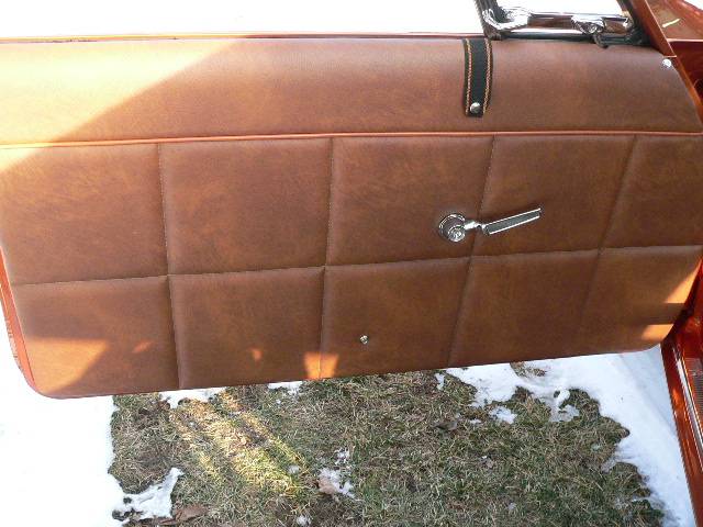

I made the boards just like 493 Mike. Then made them similar to the factory Super Stock panels but a bit fancier with a little padding for more defined depth

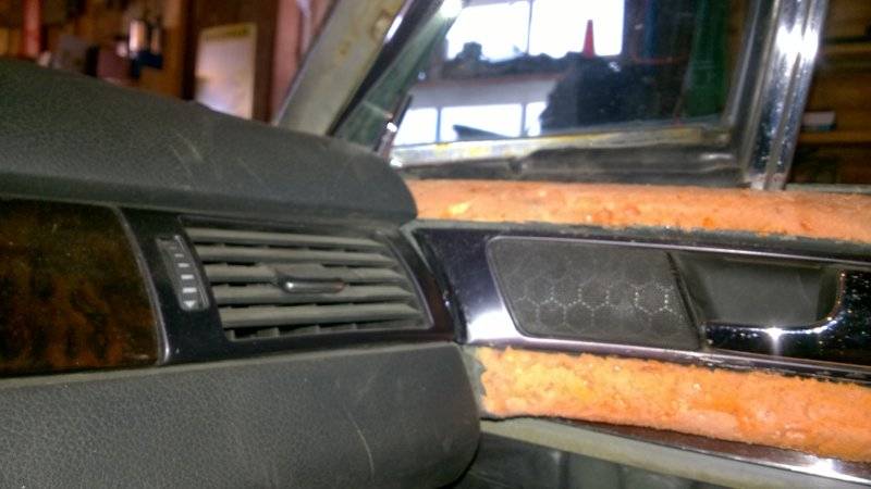

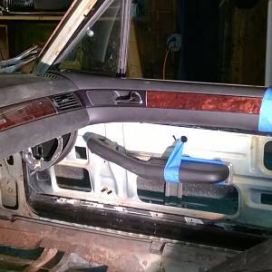

I have made my own. I too used the Masonite board. Mine are a bit different though with Audi bits and pieces and custom bump outs. Have not covered them yet. Needed to fab a bunch for mini speakers and electric locks and windows in the Audi panels.

I made 4 new panels for my 65 Belvedere using 1/8" Masonite board. When it came to the rectangular panel clip holes I took note of the clip installation direction and used round holes for the clips as they were much easier to form. I also pop riveted the Masonite to the curved steel top pieces (originals were stapled). The sun-fading is optional!View attachment 782278 View attachment 782279

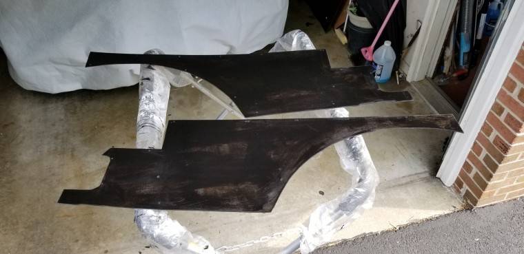

I purchased some panel material over the internet/mail order. The stuff is black and supposedly treated to be water resistant and made for door panel restorations. I guess it is some kind of masonite (don't quote me on that). It arrived in large sheets which I stored for over a year and during that time one sheet warped some and the other not so much. Could have been the way the sheets were laying.

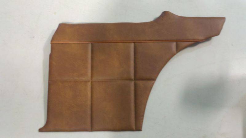

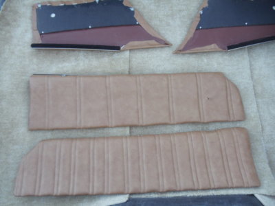

We used rivets to attach them to the metal upper pieces (painted the metal Rust-Oleum with their rusty metal red primer). It was tricky getting the slots/holes made for the door clips but in worked out in the end. Only problem was the upholsterer had a bad day and stitched the pattern for the driver's door and passenger door differently (see foto).

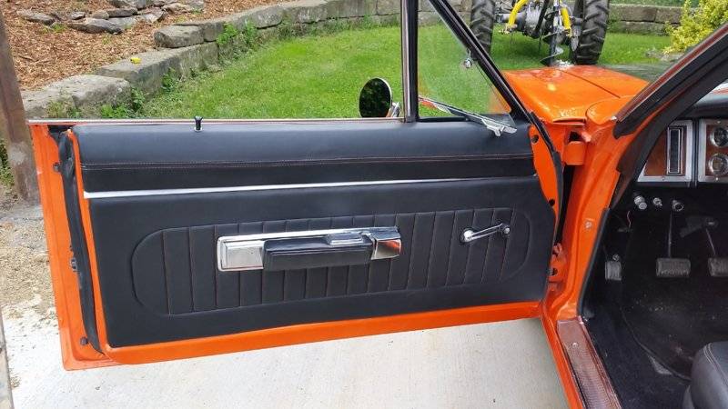

Made these out of Luan plywood but the upholstery shop did the covers. I've got the right armrest on it now.:thumbsup:

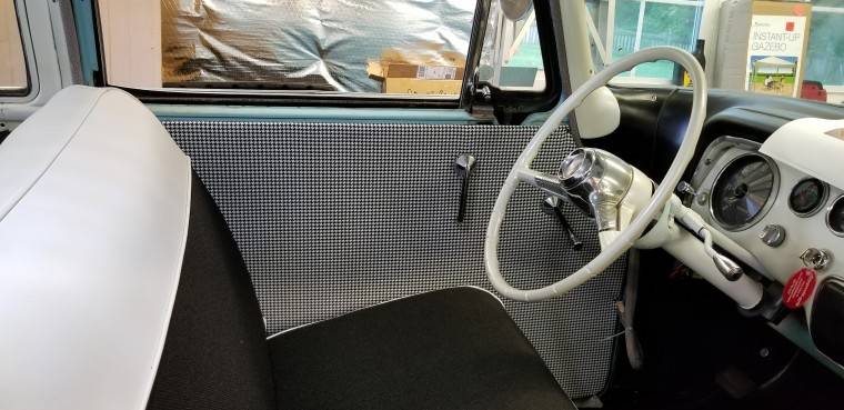

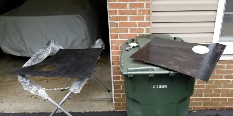

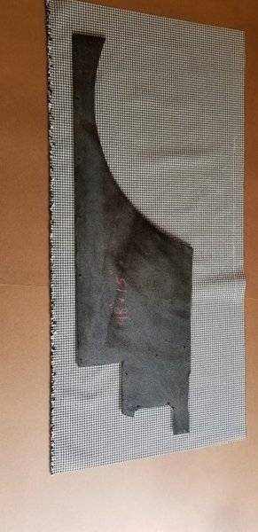

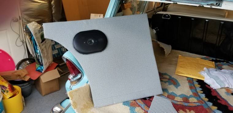

I made all new panels for my '55 Plymouth using masonite-like material that I bought from Home Depot. After I got the shapes and cutouts the way I wanted them, I coated them with POR15 to seal them from moisture. Then I glued sheet foam to them and trimmed that to the shape of the panels. I followed that with the houndstooth cloth we picked out. I'm happy with the result. However, I may redo the door panels as I used the existing panels as patterns and they weren't perfect by any means.
