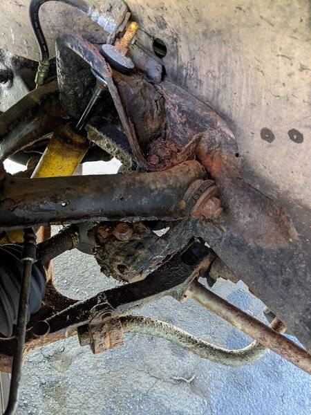

Anyone replace upper a arm saddle on truck?
Ron_M
7:58 PM
Feb 5, 2020
344
512
Connecticut
As the title says. My 93 Dakota is no longer safe to drive. Saddle is toast. See where the a arm bolt is.
Would really like to keep this truck, even if for farm use.
I have a clip from an 87... Is this possible?
I know the jounce mount toast too.
Bighouse
7:58 PM
Mar 28, 2020
836
1,359
New York
Chances are the area that bracket welds to is toast. Farm use- plate it up or section in part of the donor frame.
