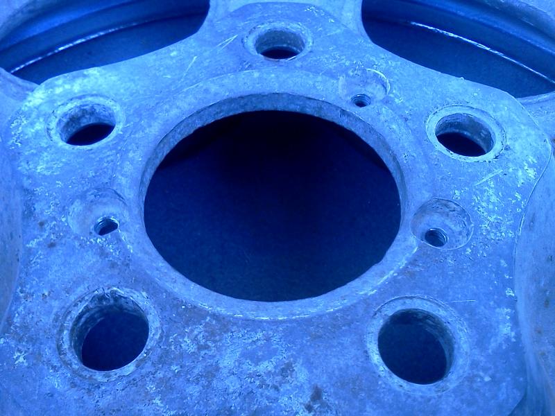

Anyone run Motor Wheel Spyders? What lugnuts?
I'm pretty sure the MW factory nuts have a shank like traditional Cragar style....but the holes are a smaller diameter.
"Regular" nuts won't fit.
The holes do have a shallow conical chamfer.
Can I run conical seat nuts?

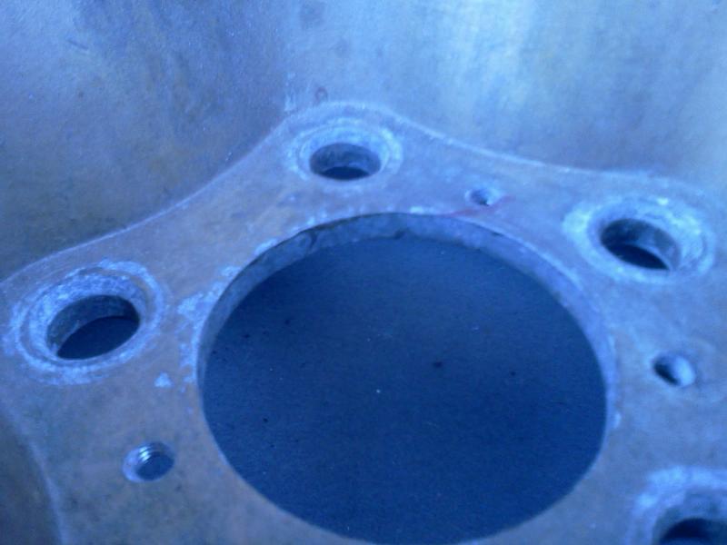

The back side has kind of a recess. One of my shop owning friends suggests this is a hardened insert.
My plan is to go ahead and run the conical nuts and keep checking the torque every few miles gradually extending the interval until I'm comfortable.
