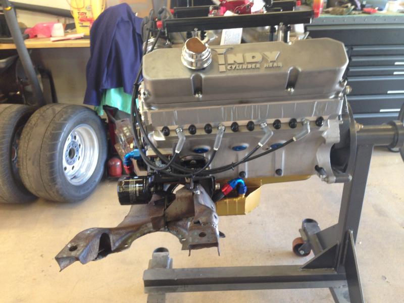

I have an aluminum low deck Indy wedge to go into my 65. 664hp, 652tq. Its the sister engine to the PHR/Mopar Muscle Violent Valiant. 450lbs with oil in the pan, manifold installed with injectors & t/b, balancer, v/c's, distributor. Have not installed it yet, but I'm going to start taking the car apart soon for it and the other upgrades that will get done to it. If I can swing it, may get started on the disassembly of the car this week.

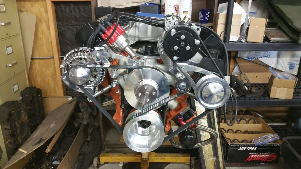

I am running the Aluminum world Hemi block with Stage V heads. What type of feedback are you looking for?

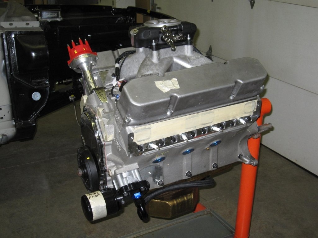

I have Muscle Motors building a 540 cu in B with Indy castings for my 65 Belvedere. In a few weeks I will travel to Lansing to watch the dyno break in!!
540 engine specs: Diamond custom pistons
Molnar crank and rods.
Comp cams cam/lifters
Manley spring/locks/retainers
Indy block, head castings, plain valve covers, valley tray, intake manifold
ARP fastners
Ackely &Childs rings
Michigan 77 bearings
Powerbond dampner for proper pulley alignment
Fel Pro gaskets
Roller master timing chain.
Ferrea Stainless steel valves
T&D rocker arms
FAST EZ EFI 2.0
Conservatively it will make 730 HP and 730TQ .
Hee Hee!
Mike
I've got the 540 in my garage! It dyno'd at 765 HP, 753 TQ! Weighed 420#s on the local farm coop scales w/o oil, no H2O pump or hsg.

My 540 is based on the "B" so I would have a shorter motor, to fit under the stock hood. Muscle motors did the build (details earlier in thread). I knew I would have a ton of money in this engine so I went whole hog and had MM. build, machine, CNC port, dyno, and tune the FI.
