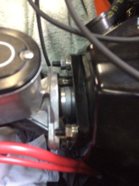

Tried Bleeding My Brakes And My Pedals Just as Firm With The Bleeder Screws Open As It Is Closed..
Just Wondering If Anyones Running a Wilwood Master Cylinder With a Factory Power Booster?
Did You Use/modify The Slug That Wilwood Provided Wither Their Master Cylinder..
Pic of Master Cylinder Gap when Master Cylinder Slug Touching Power Booster pushrod.
The Rod Wilwood included Was About 1 1/2''. I Would Have to Shorten It almost 1'' to get the 1/16" gap Thet Wanted Between The factory Pushrod n madter Cylinder Rod.. Not Sure How To even measure That
Have you tried installing it without the rod, to confirm its not the rod, need a processes of elimination?
Wilwood Said i Must Use It.. I'll Try Tmrw Without It And See If The BleedOr Get Something Different From The Pedal
What bore size are you using and what front and rear brakes? Just curious here...
I'll check tmrw. Wilwood Called Me Back and said The Pushrod they included doesnt have to be used. I Ordered A 4 to to bolt adapter from summit and hope its thinner than the magnumforce one and Will Work with the power booster rod only. Be here in a week
