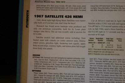

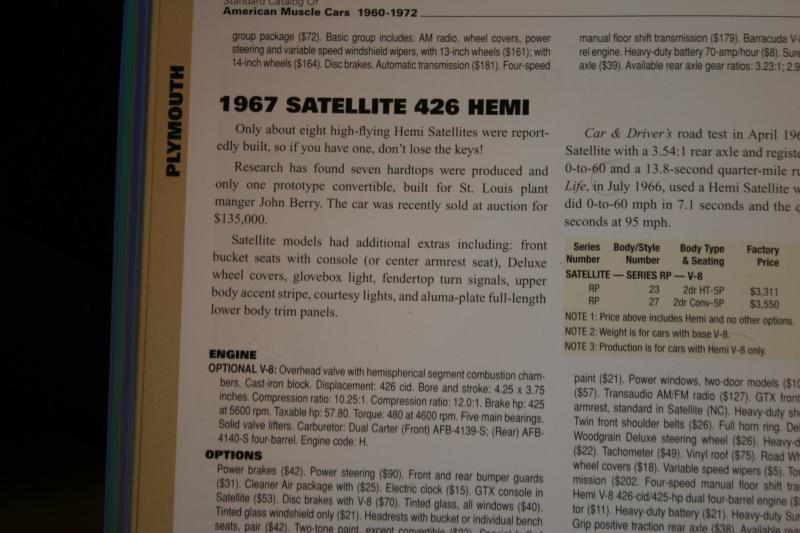

I know were talking about B bodies but....
in 66 the 383-2bbl was offered in C bodies but not B bodies. Both the 2bbl and 4bbl code as "G" in the VIN. That's why you have to know the entire VIN for a '66 383 car to know if it was a 2 or 4bbl. You have to know if it's a B or C body to know if it's a 2 or 4 bbl. They fixed that problem in 67 with G and H codes.

But they are right about 67 Hemi Satellites being rare and not even acknowledged by Chrysler until the 1990's.
