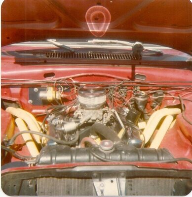

I used an aftermarket "cool can" on my bracket racer back in the '70's. It was an aluminum round canister with coiled metal fuel line inside (and a twist open/close drain at the bottom.
The first time I used it with dry ice, but I found the dry ice not only expensive (compared to regular ice), but it evaporated so fast it was just not practical.
Dry ice is extremely cold. It maintains a temperature of about -109.3°F (-78.5 degrees C) as it evaporates or sublimates and becomes carbon dioxide gas.
I noticed under normal conditions, my see-through fuel filters would always be half-filled with fuel and half-filled with vapor. No problems with vapor lock (was using a Holley electric fuel pump and a separate fuel pressure regulator.
Running ice in the cool can at the drag strip, I noticed the see-through filters no longer contained any space/vapor but were entirely filled solid with liquid gasoline.
In the photo (at the lower left corner), if you look carefully to the immediate left of the radiator, one can see the partial round lid/top of the cool can which is painted blue. The fuel pressure regulator can be seen laying atop the middle of the passenger side valve cover.

You did learn just plain ice for a cool can congrats.
