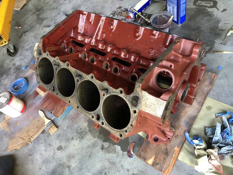

I use RustOleum Rusty Metal Red Primer.

I use Rust-Oleum. You have to allow time for it to cure, takes a while. Does it work? It's cheap enough to not be a concern about major benefit.

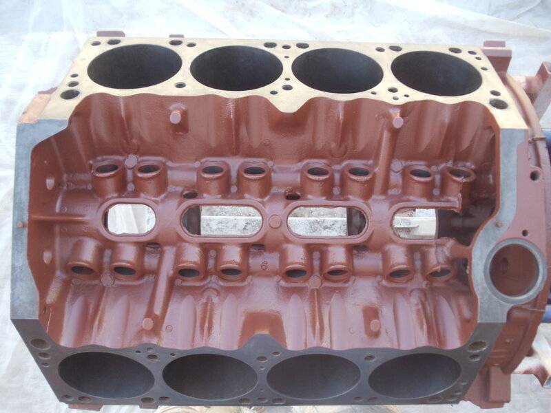

This is the last engine I used it on, a 438" stroker. We put it in the lifter valley and timing chain area. I didn't put it in the area below the cylinders or along the block skirt area this time. I thought about it, just didn't. This block went in the hot tank after it was painted and it came out looking exactly the same; no big strips came off, no areas washed away, nothing. We cleaned the crap out of these surfaces beforehand, they were spotless. YRMV if you do a half-assed cleaning job before brushing this stuff on. The guy that machined the block said it was good to use.
