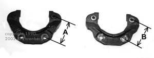

They claim 11" rotors BUT they are the same as you have now ... 10.87". The proof is the caliper bracket. For the larger rotors you would need the bracket on the left in the photo below but the bracket in the Speedway kit is clearly the one on the right. (Pay attention to the side notches)
I think they'd be more inclined to tell you if it was the 11.75" rotors. As for any advantage, this has been kicked around for years and the general consensus is that it is virtually unnoticeable.
If you have stock Mopar discs on there now then you wouldn't need this whole kit anyway. To upgrade to the larger rotor all you need is the caliper bracket and the rotor. Everything else is the same.
Agree with the above. If your car is a 71-72 you would also need 73 up spindles or the Dr diff bearing adapter to run the later discs.
