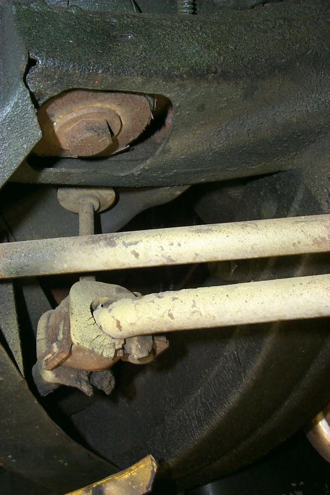

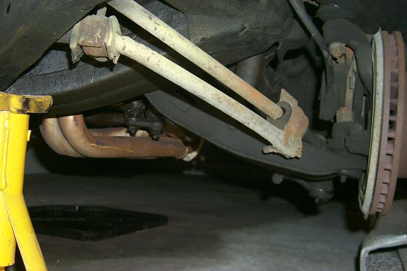

73's really don't have any "mounts" per se. Here are a couple of grungy pictures from my son's 73 Road Runner, but hopefully you get the idea:
Here is the "center" support. So for this, there is only one hole in the K member to support the mount.
Here is the end. As you can see it mounts to the strut rod, so there is no evidence of it once removed.
Hope these help...

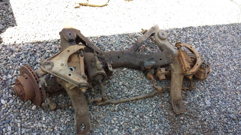

Any chance for a top down pic?
Thanks, BTW.

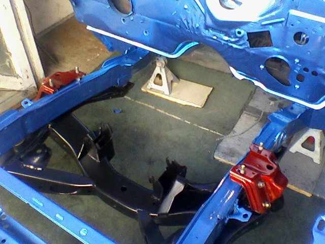

I've had 73-4 without the sway bar. Sway bar setup has gussets on the K-frame for the end links. A non-sway bar frame won't have the gussets.
this the best I have, if you look close you can see the plate with the single hole where the link drops down. im almost 100% certain all 73 and up B body K members are built with these plates welded in.

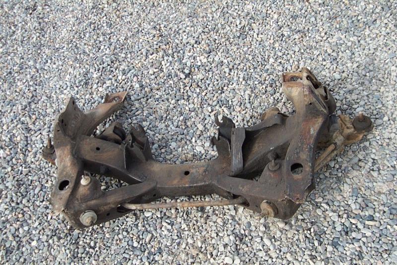

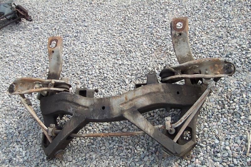

Found a couple pics with the bar.
Without

/6 and most 318 cars didn't have the bar. Some 318 and most BB cars did.
