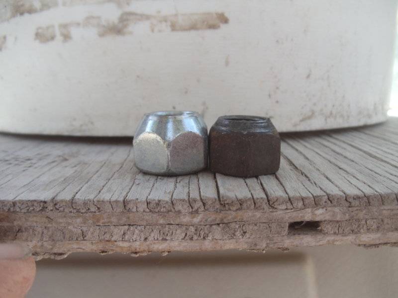

On the left in the photo, this "new" 1/2" I found locally takes a different lug wrench size (larger) and it just doesn't seem to fit into the rim hole exactly like the old nuts on my '72 BBody. I don't want to use them (I'd rather find some used ones with the proper fit).
Notice the difference in the angle of the 'cone'? That makes a big difference in how well they hold the wheels. Of course, different wheels had different cone sizes, so you have to make sure they match.
The one on the right is a steel wheel and the one on the left appears to be an alloy wheel nut.
