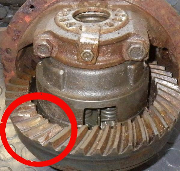

IMO it is fine. I "rebuilt" one a year ago that was shot. Milled them and put spacers behind them. It took about 120 ft lbs to get it to slip, and would leave 2 even black patches when I dumped the clutch. I broke the ring and pinion after about 1000 miles. Setting it up again with 4.10s.
A buddy has had the same 489 carrier and cone style sure grip in his 69 GTS since it was new, raced it for years, still working, still 2 even black patches when he roasts them.
Lol, They are tough enough to break these.....................
