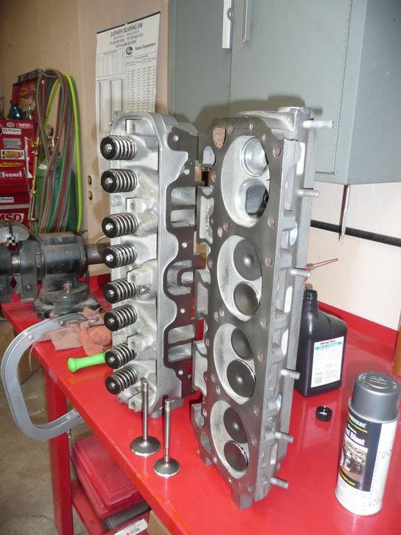

Are 440 Exauhst bolts all to the same length?
I am repairing the head on my 1968 440 heads, It has exhaust bolts that are all the same except the one in the front by the fan. All are about 3/4" sticking out of the head and the one farthest foreward on the end is almost twice as long. is this correct? It's the same on both sides. One is incorrect I know because it's on an angle and a coarse thread.

Far as I know, all the studs are the same length. And are square to the gasket flange.
As you look at the head, the one to the left is a longer stud. On the 68 440 I am building, one head was this was way. I think it might go on the passenger side rear, because the manifold uses a long stud/nut there.

I have the same treatment on the heads I'm working on except in reverse. Weird. I'll try and see if I can find out what the deal is with these. I'm putting new studs in and I want it too look and function factory correct. SO that I can slide the manifold on and off easily.
On my 69 RR 440 all the head studs are the same length. And I am also using stock ex manifolds. Some one prob changed yours in the past.

Single long stud on the driver side.
Thanks for the info, I have talked to a few others and they have the same condition and they say that it was for an AC bracket.
